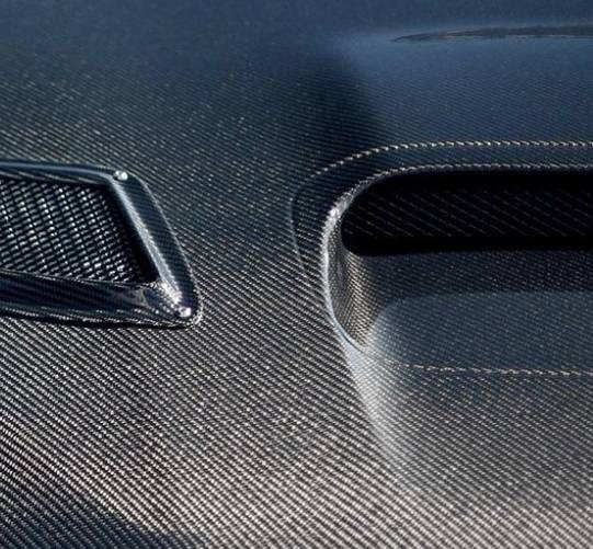

For one thing, CF is a larger diameter than 3¼, and that would require an exhaust system rework. I'm also concerned about an impact from the side by road debris shattering or cracking the CF, and lastly, I'm hemorrhaging money, and I still have other things to pay for, so no reason to double the cost of the driveshaft.
I am looking for a taller cowl version of my hood in CF though. Depending on how much it costs, like my paint and bodywork guy said he thinks he can get me a CF hood at $1,500, that is the cost of a fiberglass hood and the paint job to match, so basically the same cost, and I think that a natural CF finish hood (maybe with the factory satin black stripes) would look AWESOME on my car, and add to the unique "restomod" theme I'm loosely following.
This finish:
