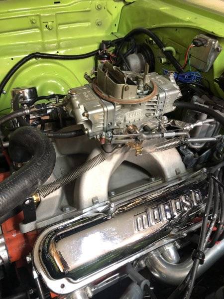

Working on my tune of the car currently. Just added a Lokar throttle cable as the original was just too short. Needs more advance and will get my wideband O2 on there but have a question about the Holly. This is a mechanical secondary with no choke by the way.
I am able to get the full throttle set with the new cable and confirm that the mechanical secondaries is getting “opened” at WOT. I however expect more acceleration when this happens as compared to all my Rochesters of the past. Again I know I am running very retarded right now as I wait for my dizzy Advance Limiter and I have not looked at the AF mix live yet so this all may be tune related. I am just curious what the difference might be of the 4150 compared to the Rochester at WOT with respect to performance acceleration.
What is your combo? Is it the sport Satty with a 340? What 4150 650 750 850? IMO use a vaccum secondary on the street. The rochestor was a vacc secondary carb. With a heavy car the double pumper is not optimal unless it is strip only.
Everyone always says put vacuum secondaries on them, I've ran both on my car and won't be putting another vacuum secondary on it. What it comes down to is heavy cars with street gears don't accelerate fast enough to burn all of the fuel being dumped in so often times you make the car slower. My argument is if your any kind of driver you should know when to floor it and when not to? You learn your car and you learn where the engine comes on strong... that's when you put it to the floor. Keep in mind I'm running 3:55's, have a standard and a pretty healthy running engine which makes a difference. If mine were stockish, I'd put vacuum secondaries on it.
Going back to your question we'll need to know a lot more than posted, are you floor boarding it right off the bat? What gears are you running? Engine specs? Carb size?

My inquiry is based on the lack of secondary acceleration. It feels very linear as opposed to my GM Rochesters of the past. When those vacuum secondaries opened you knew it. I am not aware of the check ball.

Did you already look in the Ventura to confirm your getting a healthy squirt when the secondaries open? Yes those gears are going to kill any seat of the pants acceleration, I'd get it moving good up around 3,000 rpm before kicking them in. Not sure about your setup but I can feel the secondaries in the pedal?

No I don’t feel the secondaries kick in at WOT at 3000 RPM or so. This why I am asking. This is my first Holley and first mechanical secondary. It has a linear acceleration like the secondary not coming in. I will check the squirt to confirm fuel delivery.

If you had no fuel or it was lean when the secondary's open on your holly you would know...the car would fall flat on its face or worse back fire thru the carb. your holly has front and rear throttle plates that are the same size. the rocherter quadra bog has massive secondarys that you cant help but feel when they open as the primarys are very small. also with your rear gears if you open your carb at a low rpm the motor will rev slow till it comes on the cam. My old 340 did not come on till 3000 rpm. I ram a 6 pac, when it was open on all 6 everyone around knew it....
No doubt the rear gears are dogs and I am planning on changing them as soon as I can afford it. I am definitely get fuel in the secondaries.
It sounds like the linear acceleration is because thats the way a double pumper works as compared to my Rochesters.
If the car runs good and doesn't bog or pop back your on the right track . a 650 is also a small carb. Also make sure your kick down is adjusted right.
