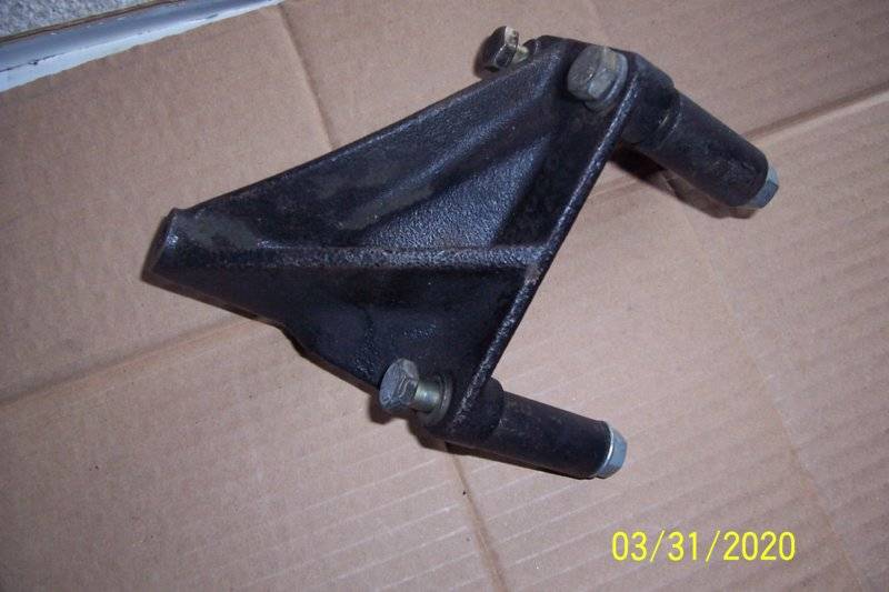

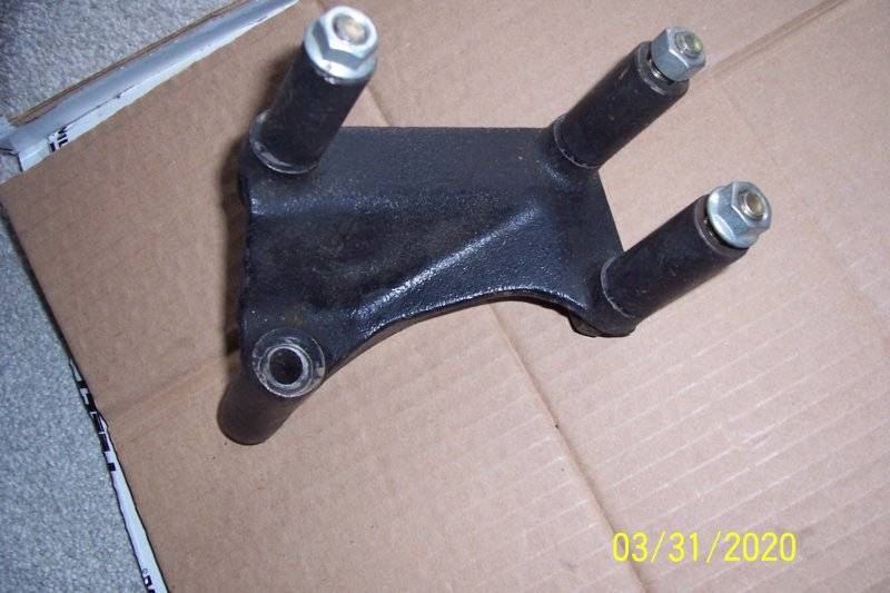

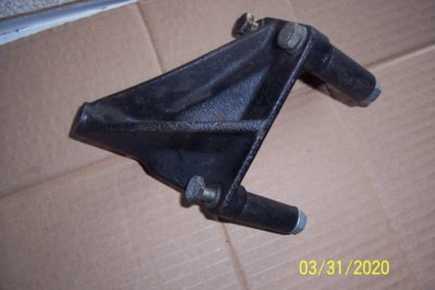

part # 2808039 what is it and off of ? thx
1968 and older alternator mount to cylinder head with AC. BB engine
1961 413 with no AC uses this also.
Those long tubes do not go with it.
Those 3 holes bolt to the head, the other hole on a different plane is for the alternator pivot bolt.

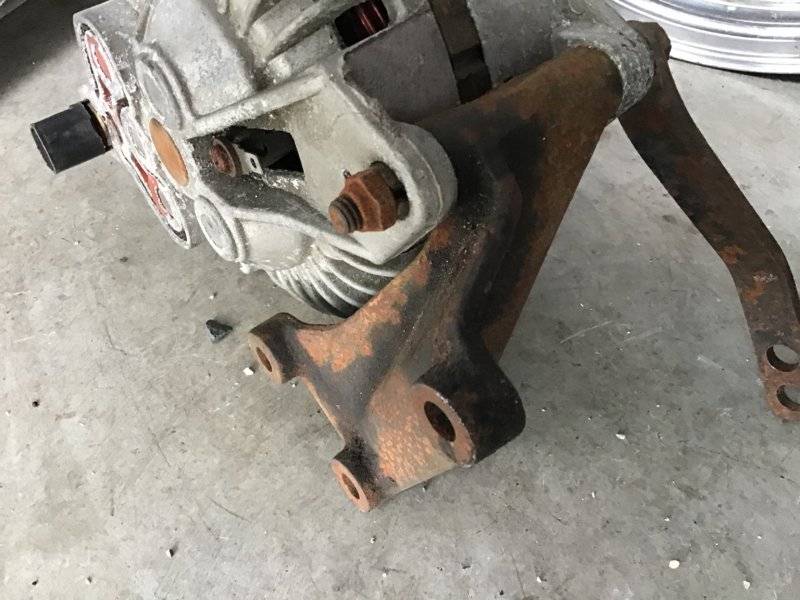

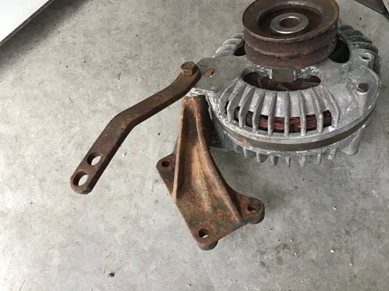

here’s one off a 68 Imperial 440

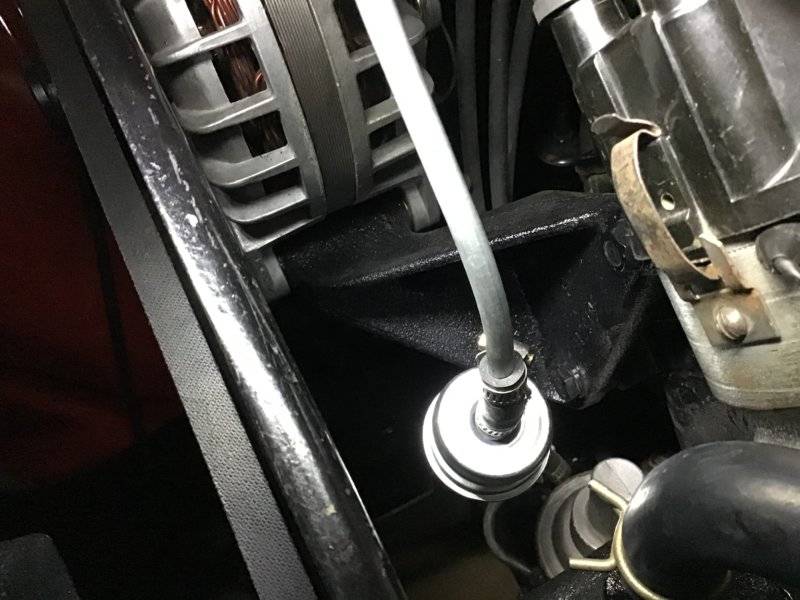

on the car is a 1961 413. Number on it starts with 212, looks like the alt is further out from the head
