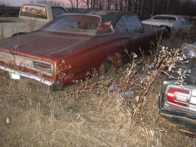

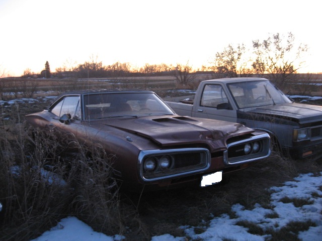

Looks like a great project. How is the trunk and underside? If they are clean then I would say seems like a good deal but, would have to see it in person.
I'll have to check on those two things, is this a rare type car?? or just a regular super bee?
Sorry for all the questions but which would be the better buy, both in similar condition and everything. this 1970 Super Bee or a 1969 Super Bee original b5 blue with the original 383 engine in it and tranny??? this 70 is $4500, the 69 is $4800 what's the better deal?

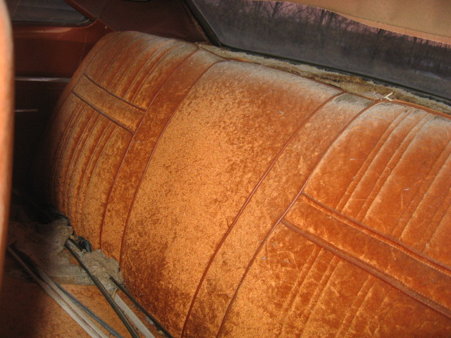

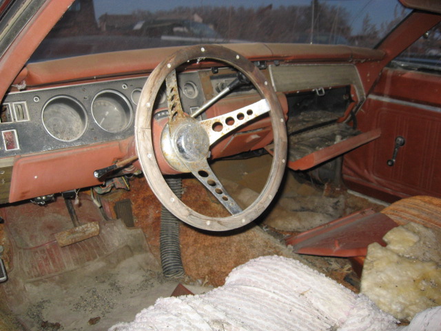

Alot more info and pics would be neccessary to determine which one would be the better deal. For a novice such as yourself, you would be well served to go with whichever one is the easier resto. What is the `68 Plymouth next to the Burnt Orange `70? Either way do not be nervous to start you're offer to buy much lower then what they're asking, the more you save on the anitial investment, the more you have in the resto fund. Approach these projects like you know what you're talking about or bring someone in the profession along with you that does, so that the cars can be assessed before a deal is made. For example, This `70 Super Bee is going to need interior floor pans, trunck floor, outer wheelhouses and the rear crossmember along with some work on the inner cowl and around the rear window corners because its been sitting outside for who knows how long and the engine is stuck, so who knows if it's even buildable. So your asking price is $4,500, I'll give you $2,800 cash. If there unreceptive to that then prompt them to counter offer. That was purely hypothetical, but you get my point. Take lots of pics and make sure that it's #'s matching if the owner say it is. Does it have a fender tag? what's the vin#? If the car still has carpet in it that probably meens the floors are shot, these cars generally leaked around the front and back windows and if the water has nowhere to go but carpet, it will rot through the floors and into the frame rails. Go look again and post up what you find, we'll help you get the best deal.
Ditto on Matts comments. But rear crossmembers don't normally rot out, they are stout pieces of steel. I would say what's your garage space look like, do you have room not only for the car as is, but, when you start yanking it apart, do you have room for all the parts, and good storage? Do you have a game plan for this car? I say get the 70, they are unique, only made one year, and the front end looks mean. The 70 dash is cool, dual gauges. If this car was used in salt weather, be prepared for massive rust, if you want to get a worse-case scenario go to my GTX thread here. Do you have the tools and skills to tackle this? If not, be prepared for a long haul restoration, probably like 10+ years.

Check both cars' vin# and fender tag to be sure they are SuperBees and not Coronet 440s. Also check the stampings on the core support and driver side trunk gutter to be sure they match the vin. Decode the fender tags and see what the cars were born with compared to what they have now to see if hard to come by parts are missing.
All things being equal I'd buy the one that has better options on the fender tag- color combos, ramcharger, dana, etc.
If both car are similarly equipped, but the one that needs less metal work or has fewer missing parts.
