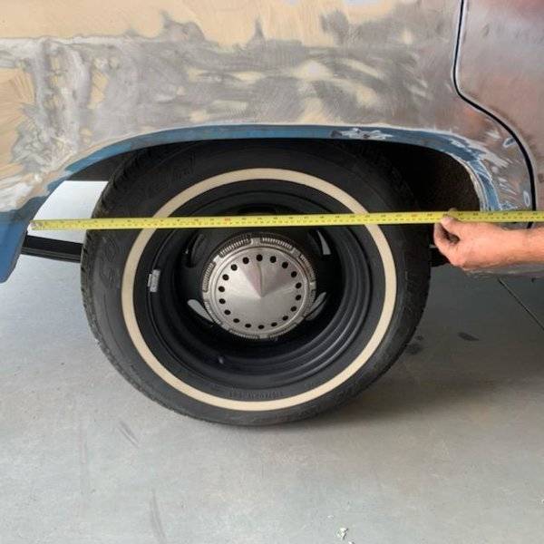

1. Is the tail panel (where the tail lights go) the same on a 4 door as a 2 door?
2. Is the sail panel (panel between the rear window and trunk) the same on a 4 door as a 2 door?
3. is the trunk pan the same on a 4 door as a 2 door?
4. Is there a patch panel for the rear quarter panel for behind the wheel well and below the marker light?
5. Where can I buy the best replacement panels in terms of price and quality? Right now I am looking at Classic Industries "Restorers Choice" panels.
Thanks in advance for any replies!!!
1 yes
2 no
3 yes
4 2 door panel may work but wheel opening is different
1 yes
2 no
3 yes

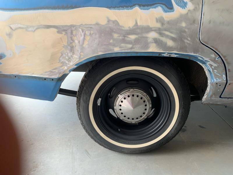

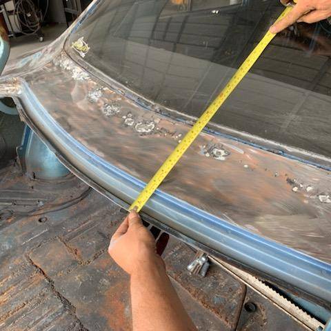

YY1 how is the wheel opening different? Do you know if anyone sells the 4 door quarter panel? Does anyone sell the panel under the rear window for the 4 door? It is hard to see but the measurement across the rear wheel opening for my 4 door is about 28 inches. Would you be willing to send some pics and measurements of the 2 door wheel opening and the under the rear window panel?
The wheel opening on 2 doors is bigger.
The good news is that 4 doors typically don't rust in that area so finding donor metal is a lot easier than for 2 door cars
I have a pair of quarter panel cutoff sections from a 1968 Coronet 4 door. I'm not sure if 68 is the same as 69. I don't have the rear window to trunk lid panel.
