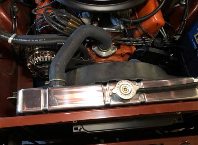

Fits perfectly, but I did replace the factory upper hose with a Gates #20355 upper hose. STRONGLY recommend doing this as these pictures show the factory upper hose for the 26" radiator is about 3½" off from where the connection is on the Cold Case MOP 754 shown w/the #20355 in the second picture.
Factory original upper hose:
Gates #20355 :thumbsup::bananadance:

thanks for the heads up on the upper hose. I wish I could do half of what your doing on the car. looks nice I hope it works out.
what shroud is that on the radiator?
Those pix were lifted from a forum member, so I don't know.
