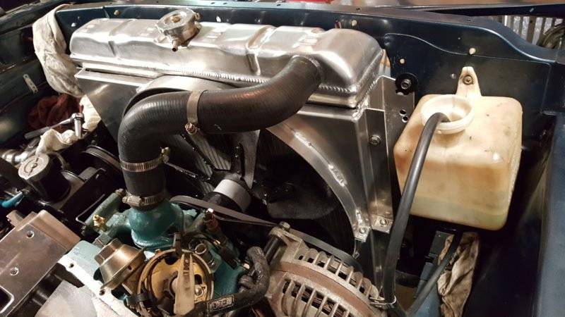

BB radiators upper hose goes on pass side of upper tank. You can see a flat spot where they put it. I recored small block radiator with 4 rows
but left hose inlet alone.

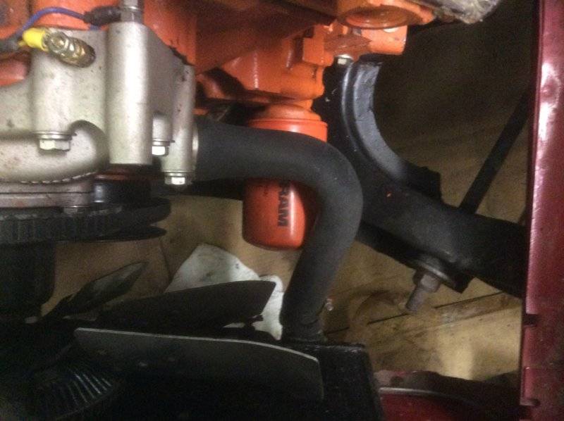

Yes. Driver side is the left side for me also. I have only owned two small block cars. One with a 340 and one with a 360. Both had the lower inlet on the passenger side. Obviously, I'm not up to speed on the 318's. Another thing I was not aware of is the oil filter being in that location. That pic sure looks like a big block to me.

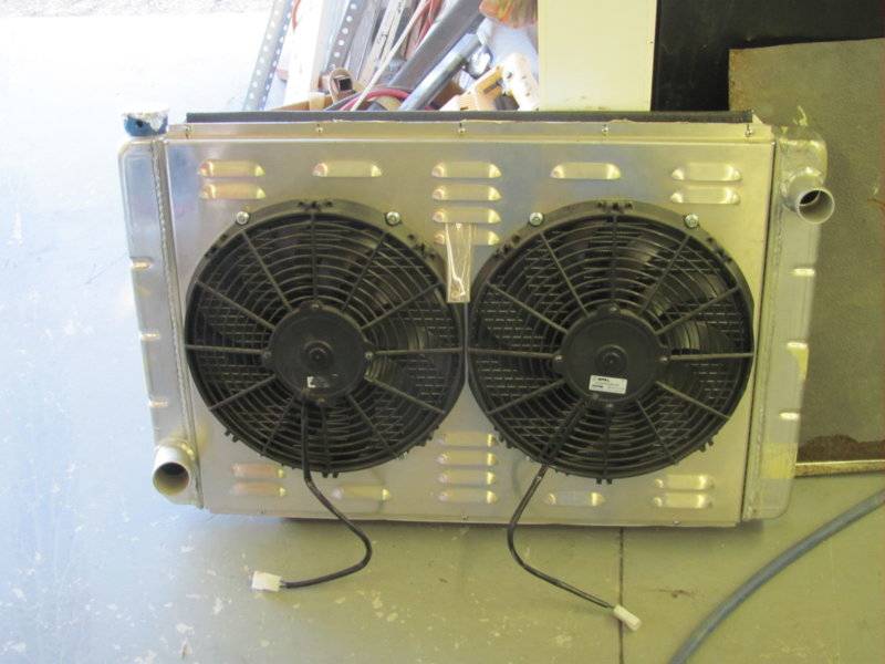

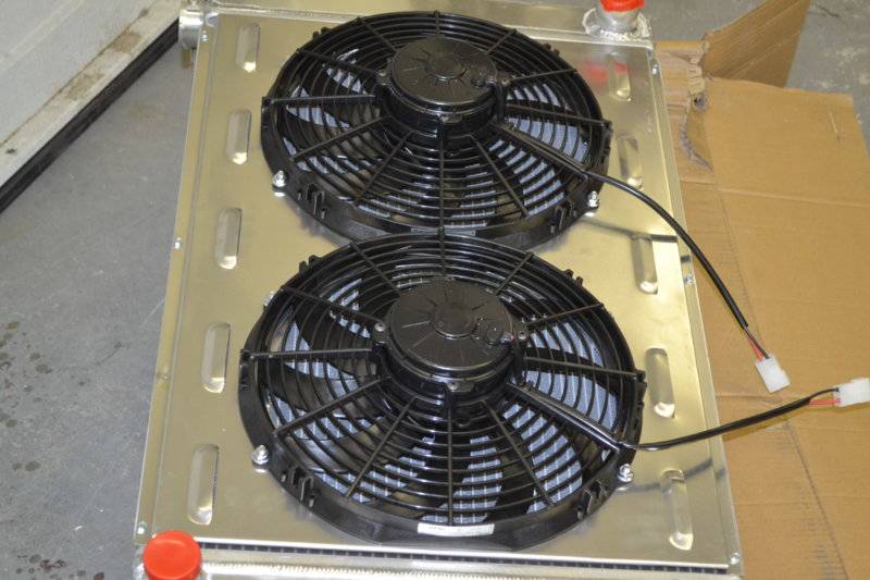

View attachment 803103 View attachment 803114 Just food for thought . If it is start to heat up with your current motor and you place the new stroker motor it will possible run hotter . I have seen this happen quite to often . Why not just get a new set up for cooling it . My latest car project has a 31x19 aluminum radiator that has 2 one inch tubes with 2 12 inch spal fans with a shroud that will pull over 2700cfm all the time . It came from Dillon Radiators in Rochester min. They have a web site on line . I had to clip the edges of the frame rail in order to get it in place . With a wiring kit you can control the fans manually or let them run when the motor heat calls for it to turn on . Doing this will allow you to remove the fan from your motor and free up a few hp . When I purchased mine I got it for $300.00 with free shipping on ebay from Dillon Rad. Just a thought . Hate to cook a new motor . P.S. Pics of radiator is in my 66 cuda frame rails do not need to be cut back that far , can take and send more pic,s if needed , John
Sorry pic's did not load correctly .Pic of radiator is from Dillon Radiators . you can get hoses to go to either side of motor . Used this to clear steering box on AFX car .
