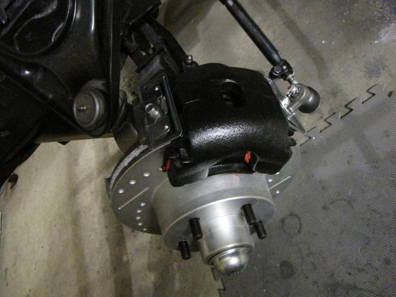

I was told it was front brake conversion from a 73' dart
Your brakes look like this sublime? This is early-mid A-Body style.
