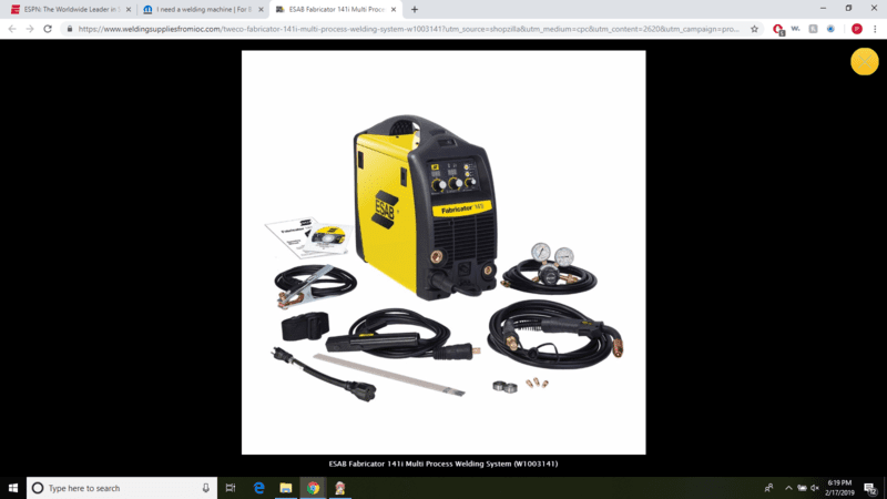

I have a small 110-volt Hobart Handler 120 I bough around 1990. It has the shorter torch but is not too bad to move around. A Few years ago, I bought a Tweeco 181i multi-process machine when they were discontinuing them, I could not pass up the $500 price. It is 220-volt so it will need the less common power outlets.
A machine that will work off both 110, and 220 are nice. The old Hobart 110 volt machine is often taken to friends houses to do small jobs, where the 220 volt machines stay in the garage. In welding school and the exhaust shop, we used the large Miller and Lincoln machines that had 25+ foot torches which are nice for getting the torch in the correct position, but they weigh quite a bit on those 350 Amp machines.

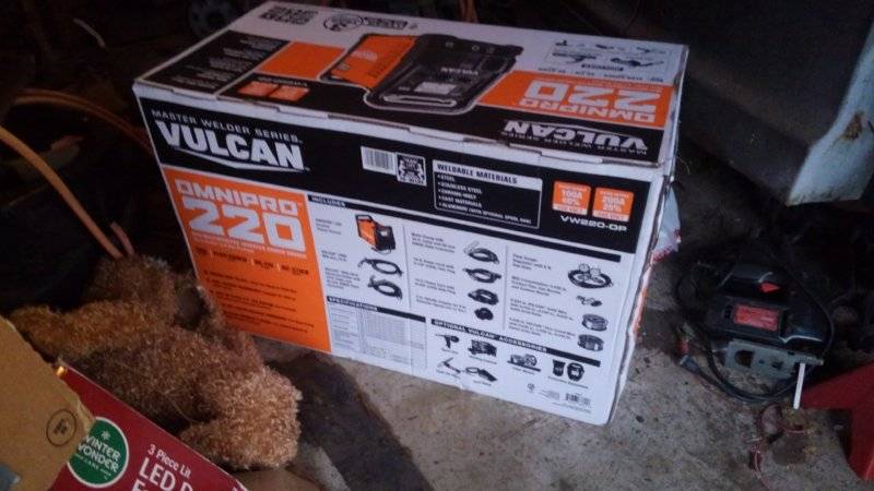

Just bought this gal myself! I've yet to weld with this unit but I used my buddies and he has the 200 and it's sweet! I wanted the Tig ,mig setup so I got the 220n man I'm thrilled with this unit the digital screen does basically everything for you it adjust the amps and speed accordingly . Tomorrow I am going to get my gas refilled so I can start welding with this new unit !
