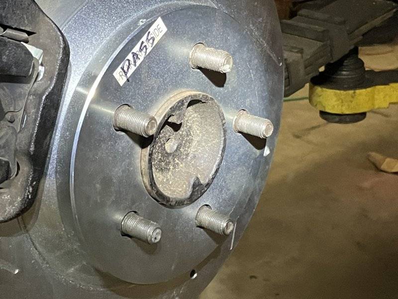

Maybe I never noticed and have been lucky all these years.
I just installed new disc rotors in the rear axle and noticed how short the wheel studs are. These are the stock 1/2" style studs....I'm guessing 20 threads per inch?
I'm showing maybe 7/8" of stud sticking past the rotor face. I'm running aluminum wheels which have a thicker hub face.
I know Dorman makes all sorts of wheel studs. Who knows a part number for something about 1/4" to 3/8" longer?
Thanks!

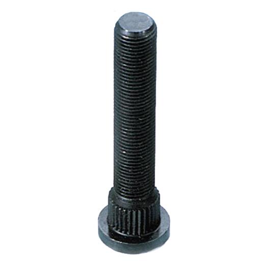

Kern, about 6 weeks ago I got 5 1/2x20 wheel studs from O'Reilly's and they had the proper dimensions for the knurled width as the original studs. They came in different lengths and actually had what I needed in stock. I was converting my last l/h thread to r/h.

Thanks. The three inch length can be cut down to the length that I need.
Do still have the part number of those RH studs to share? Thanks man
The part # I needed was 610-132, but this is only for front wheel that is 11" drum brake. rear drums are different and so is 10" drums. These are made by Dorman so may be available in other auto stores also. As Wild R/T stated they only come in one length.

.684 knurl... Should make for a pretty tight press fit but doable & the length is good...
Yeah lining up the knurl with the cuts made by the OE studs helped. They tightened up a bit (a good thing) the last little bit of the way in but overall they installed pretty easily.
