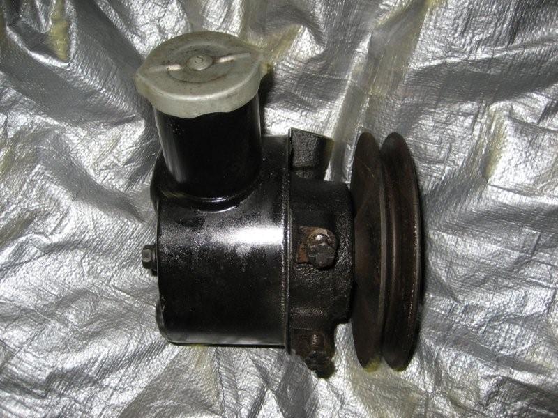

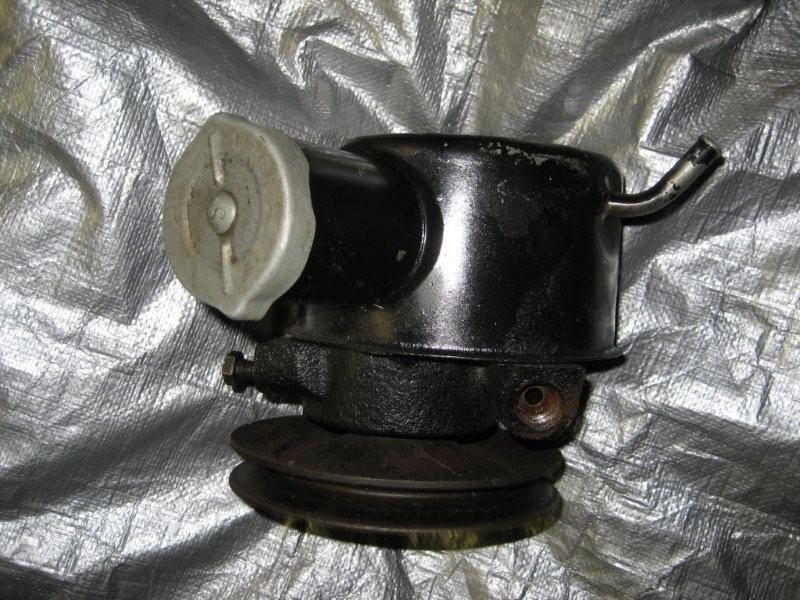

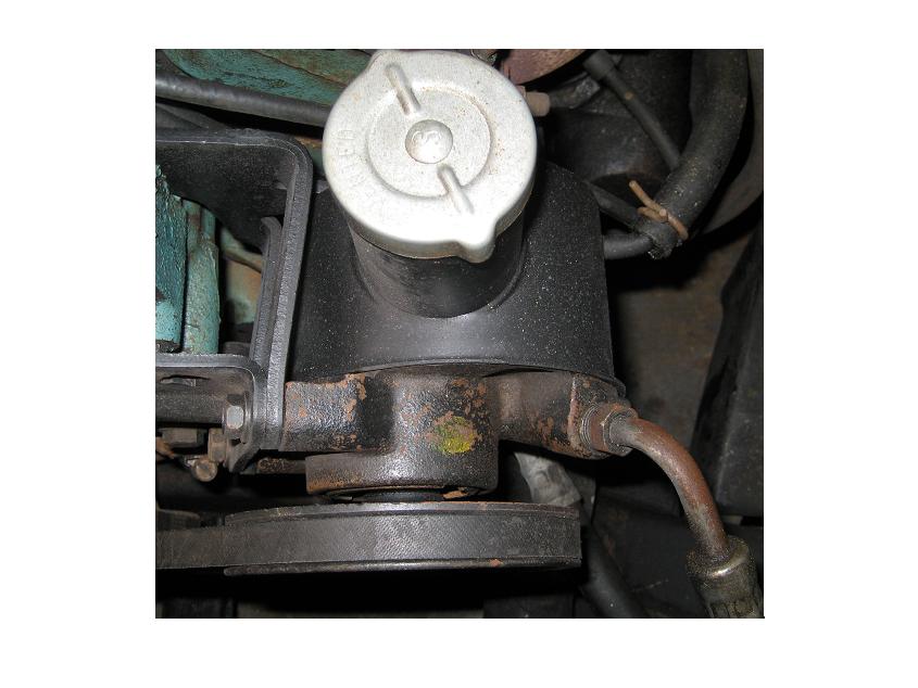

There were federal and trw pumps for 68. Both have the round neck and look about identical. The TRW will have TRW cast on the pump near the pressure hose area, federals seem to have been more common. If you do have a federal pump I'm sure I have a resivor here. PM me if you are interested
As stated saginaw pumps have a taller and kinda oval neck, federal and trw's have a short neck that is round
here are some pic's the one on the car is a federal and the one off is a TRW

Thanks for the info on the pump types guys. That is great. I think that I can tell what I have now.
