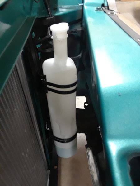

Used two existing holes to bolt a piece of aluminium to.

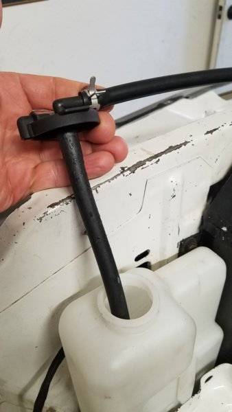

Kryslerkid, you can use you present tank as a recovery tank by plumbing the hose from the rad to the bottom of the tank and using the top fitting as a vent/overflow.
