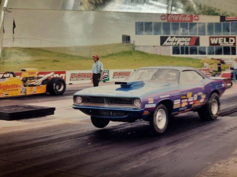

The 440 in my old '69 race only Cuda back in 1990 was a stock 6pk bottom end, less than 10:1cr, team G/850DP, template ported BV 906's and the old Herb. .650"/.650" [email protected] sft, which I thought was quite mild tbh, that motor made around 520fwhp according to my weight/mph and I turned 6700 in the traps (4.88/32") so only around 30>40hp less than my mates current on track performance with his superior heads and more comp. My only experience in running a 440.
