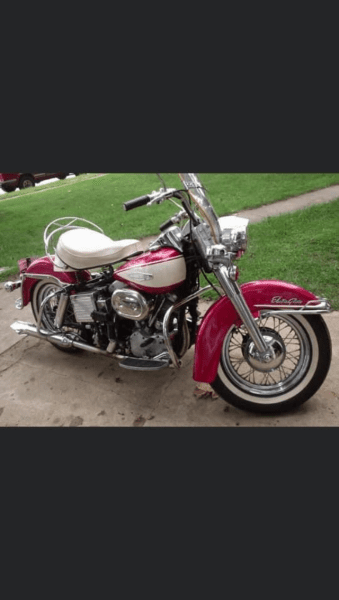

I had a mint original 67 Harley that I would spray the entire bike down with WD every winter.... and wash it off with soap and water in the spring
The whole bike? Holy smokes! Even on the paint?

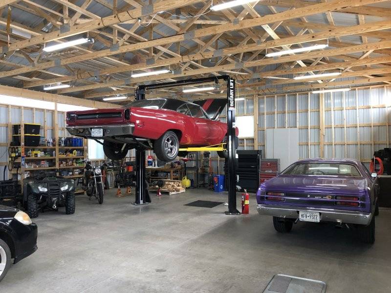

@PlymCrazy Are the cars going to be stored in a pole barn where it's damp? Does the pole barn have doors or a dirt floor etc? Humidity is humidity no matter where you are and even it the pole barn has doors etc, a dirt floor isn't your friend.....
I've used DW....I mean WD-40 too but down here it dries up even in the winter so transmission fluid is what I use. Years ago I had a 67 Dart that was rusty when I bought it and would spray it down with my used oil. It actually quit rusting lol but whenever it rained, you could see an oil trail going down the driveway.
No dirt floors. My hope is to eventually insulate and heat it within the next few years so I can get more use out of the place when I retire. I kept my wife’s ‘70 Nova out of the pic. Don’t wanna pick a fight around here.

36’ x 48’ x 12’

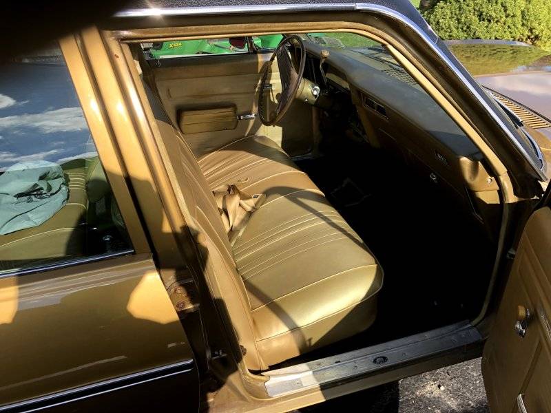

Nick post a pic of the wifes Nova its a great car.
1970, 4DR, 307, Powerglide, A/C
71k miles on it believed to be original
One spray it’s had
FL car until about 8 years ago
All matches the cowl tag except for:
1) originally was white vinyl top
2) originally was cloth seats, not vinyl
