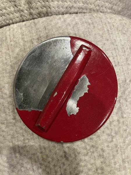

Bought a car with a very poor paint job. Since it will be impossible to color match, I want to remove the red paint, and retain the metal finish on the gas cap.
What process is recommended to minimize damage? Thanks!
A chemical stripper (your brand of choice),
I have no real recommendations on brands
& then neutralize what ever it is that you used, before you go forward
& then, do like a 000 Steelwood buff, maybe clear it after, so it doesn't tarnish or rust
I don't know if that is stainless or not
A bath in Acetone and a brass wire brush should do the trick.
gas cap can go into a blast cabinet........ "aircraft stripper" is my go to for things that cannot be blasted
Thanks. It’s the original cap. not sure what the factory used but don’t believe it’s stainless.
Thank you! Is “aircraft stripper” a specific type of chemical paint stripper? What’s the advantages you’ve seen to be a go to?
Appreciate the ideas everyone. Thanks for the help!
I used aircraft paint stripper on this piece. It took the paint right off in about 15-20 minutes - no damage to the metal.
