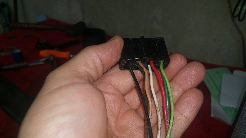

Still fighting to get this install finished. I got the column I just fine and the for is good. I couldn't use my old steering wheel adapter for the Grant wheel so I had to order one from Ididit. Last step is to hook up the turn signals. The problem is the adapter they sent has a different plug on it than mine. My writing was all butchered when I bought the car so I am guessing the plug is not correct. Here is a picture of mine. Can someone confirm if this is what theirs looks like? Or if someone recognizes it from a different year can they tell me which year? I would rather order an intact adapter than cut and splice into the one I have.
