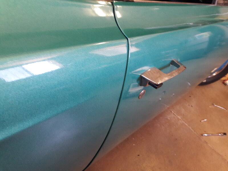

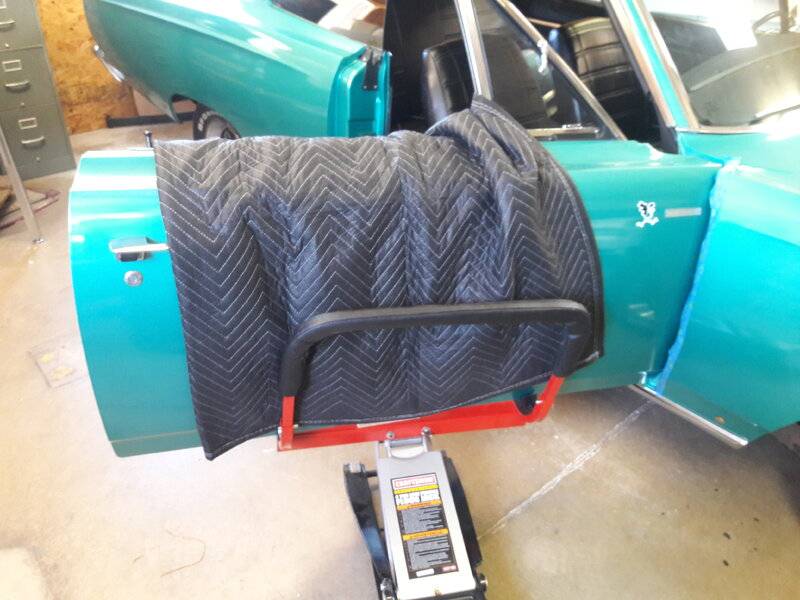

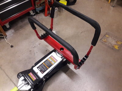

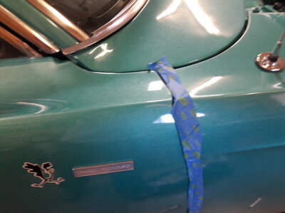

Couldn't believe how fast, simple, and easy this job went. Summit racing $110 tax and shipping. Chinesium, but good enough for the job. Will tackle my friends 73 mustang hinges next.
20200528_193741.jpg 20200529_105635.jpg 20200529_114554.jpg 20200529_114550.jpg
Nice, now to make one thanks for sharing. That rr is just outstanding. The color is awesome.
I bought the tool to see if it made the job easy. Now I will become a roving hinge swapper. Two friends now in line to use it.

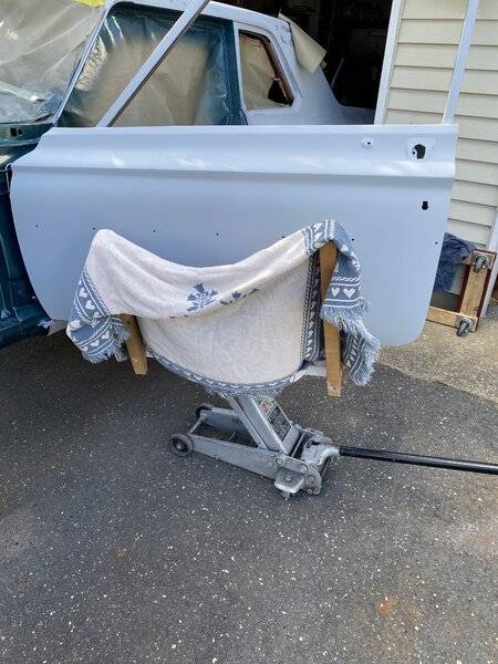

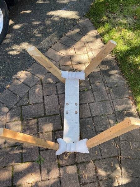

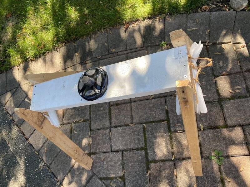

If you don’t want to spend the $100 for a one-time use tool, consider the home made version, lol. Screw some arms to a 2x6 and screw it to the jack saddle. Worked well enough to get me two doors back on.
