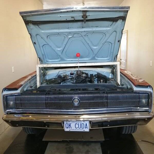

I just put a new cam in mine. Mine was complicated by the fact I had factory A/C which I did not want to disconnect, so I had to lift the condenser out of the way. The cam will come out with just the rad removed. I think I took out the two outer bolts on either side of the grill support, just to give me a little wiggle room, but I did not have to remove the grill.

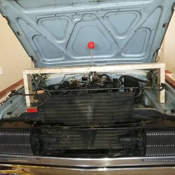

Here is another picture. I did end up removing the center section of the grill, because the previous owner had only put three of the six bolts in it. I think it gave me a little better access but was not really necessary.
