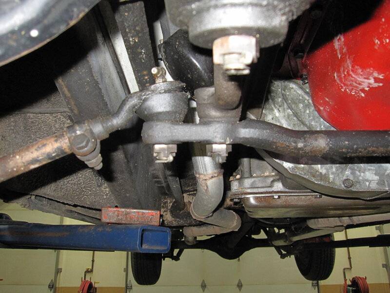

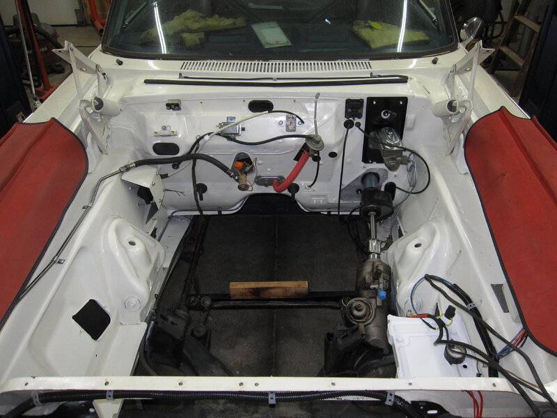

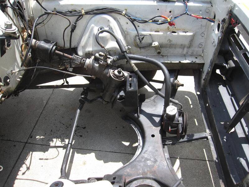

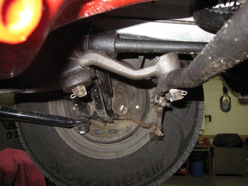

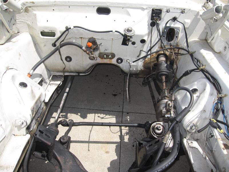

Can someone send me a pic of their drag link and Idler arm from their 65 Dodge Coronet? I'm thinking that someone replaced the idler arm with the wrong idler arm,
Does this help Ron?
Mike
Ron,
The drag link measures: 20 15/16" C-C on inner holes and 24 9/16" C-C on outer holes.
The idler arm measures: 5" C-C of the mounting studs and has about 1 3/4" offset.
Mike
Ron,
Mike
View attachment 1141994 View attachment 1141995
Thank you Mike, I brought this car about 20 yrs ago. It didn't run with the 273 in it. The past two yrs it been on my rotisserie for a year of that, so this info is a big help
