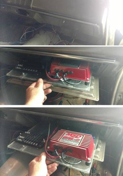

If it's strictly a race car, I did this for a friend on his 63. It's a piece of lexan on drawer sliders in the glove box. Works pretty good and is real easy to access.
