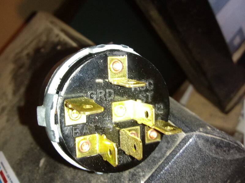

I bought a new ign/key switch for my 68 charger and it has an extra male connector blade. It is the one marked grd and my stock harness connector plug has a slot for it but no grd wire. Do I need to add a ground wire to that male grd blade? I did installed the new switch already and it seems to work ok without it grounded with a wire.
I’d double check the FSM if it’s supposed to be used use it, also take a test light and verify no power on that lug.. just in case it’s marked wrong .
You can never over ground an electrical part. Number one cause of intermittent problems are grounds.
Ignition switches don't need ground, EXCEPT if they actually send ground at some stage, which in this case is not. Some mid to lates 70s Mopars do as far I recall.
Would be nice to check if the switch actually RECEIVES ground or the tab is really to SEND ground being taken throught the chassis

IMO you cannot over ground the vehicle, when new the cars obviously worked fine but now 50 years later, the wiring is not what it was and adding grounds can and do help. Put another way, grounds are not harmful and you have nothing to lose by adding them. Why this switch has a grd tab is beyond me but I would probably grd it, it just might help that switch live longer.

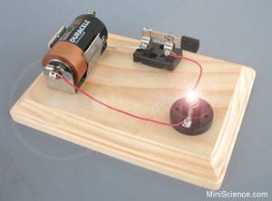

Ign switch DOESN'T NEED GROUND TO WORK!!! is just a mechanical part what routes power from one side to the other, or simply cut it. If was an electric or magnetical piece it would but is not. The ign switch is just like the wall switch to turn on your bedroom roof light. Your light needs ground, but not your switch.
Once again, an erroneous conclusion. Are you sure the ground tab on the subject switch is NOT for the key buzzer contact or perhaps for a vehicle alarm contact. Only a complete disassembly of the switch will verify it's use. Or a thorough study of the specific vehicle's FSM wiring diagrams. BTW...the little science demonstration looks nice but serves no useful purpose other than to confuse the audience, as it has nothing to do with subject at hand. In addition, because a "home light switch" is grounded by code requirements, separately and thru its enclosure, to prevent an electrocution of the user, should any current carrying parts become damaged or wet.

What's the voltage at the coil while cranking? I believe IGN2 (brown) sends 12v from BATT to the coil, bypassing the BR when starting. In run position, the BR is back in the cct from IGN1 (blue), reduced voltage to the coil. When I changed to a pertronix system and removed the BR, I forgot to connect the brown and blue together, which acted similar to what you are describing. Don't worry about the GND tab. Some of the accessorized Chryslers, ets, had a ground wire connected to it. If your harness didn't have a wire for it, it should not be an issue.
