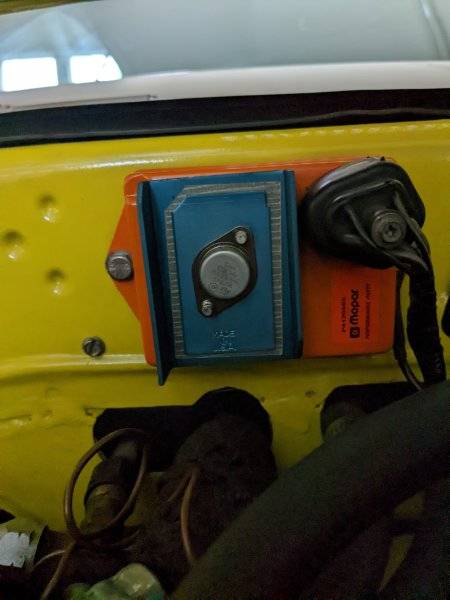

I am using the mopar orange box.
Does it state "mopar authorised" or "replaces mopar ***" on it. The new replacement what I call not real orange boxes have alot of issues.
The fuel pressure gauge reads 5.5 psi when cold, when hot runs 0. It is a oil filled gauge, my understanding is they don't work well when hot? I rebuilt the Carter fuel pump about a year ago.
It does not start right back up It takes a few cranks. Fuel float levels are good when I first start never checked when hot.
I just checked the ECU it has a mopar performance sticker in it and the center says made in USA?
OK to eliminate the ignition next time it quits make sure it has spark.
0 Fuel pressure is typically not a good thing - And you having to crank it over for a little bit to refill the float bowls answers your question
Does that look real?
