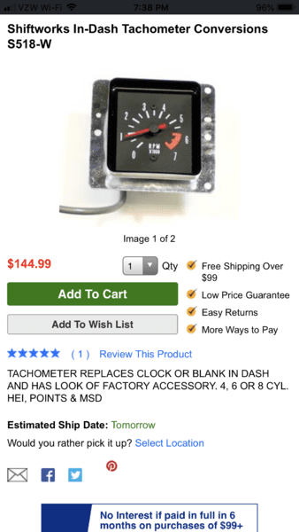

I am curious if anyone tried using Shiftworks Tachs in their dash where the clock goes? My need for a tach and a lack of a decent place for it coupled with an empty freaken clock slot is screaming put it there. Just curious how it would work and look there....

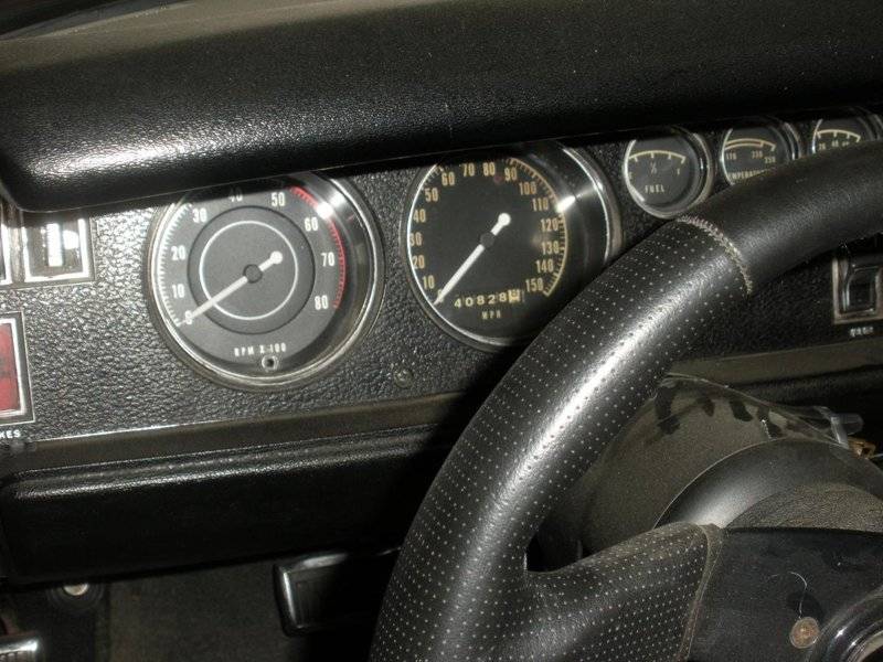

Those look great but they are sort of small. I'm guessing that you have a "sweep" dash? The standard cluster and not the rally version with all round gauges?
If you had a Rally dash frame, these clusters are not hard to find.

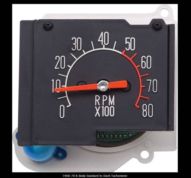

It would look just like this in a standard dash. WOW the cluster in this picture sold for $2195.00 on ebay.
Sadly standard sweep KD
Lol who would pay that much geeeze. I know that gauge is small but I think it would fit. Its auto so all I really want it for is idle and cold start throttle control.

I guess Moparfiend was a Chevy guy at some point. That tach he posted is for Chevelles. https://www.summitracing.com/parts/siw-s518-w/applications
Engine Type:L6
Make:CHEVROLET
Model:CHEVELLE
Beginning Year:1971
Ending Year:1972
Engine Type:V8
Make:CHEVROLET
Model:CHEVELLE
Beginning Year:1971
Ending Year:1972

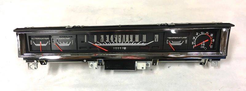

Just get a 71-71 b-body rallye cluster that has the tach option already.
Look to spend 250-350 (shop around on ebay). I had to piece together a rallye cluster with tach on mine. Sadly so many got cut up for aftermarket radios. If you find one with a clock option the tach replaces the clock. Same housing/bezel.

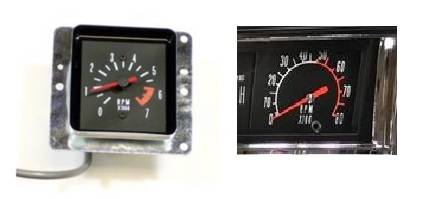

Just made this for you.
Awesome that you did this for me man! Really appreciate that you took the time to do this!!
No problem,, Just pop this tach in and wire it up with the harness. It can be done with the cluster in the dash but you have to work for the Cirque du Soleil. Or just be really really drunk and limber.
