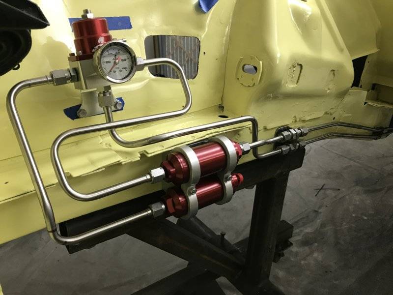

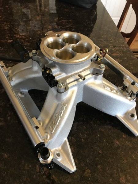

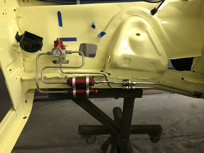

This too is my first at bat with EFI. I chose the Aeromotive 340 phantom and the Edelbrock ProFlo 4. The ProFlo needs around 60 psi so I figured the Aeromotive in tank was the way to go. Still in the install so I can’t say one way or the other. The intank is quieter than the external but a PITA if it fails so ...I’ll keep updates going and I hope you do the same, good luck

Are those filters in and out of the regulator? What is the reason?

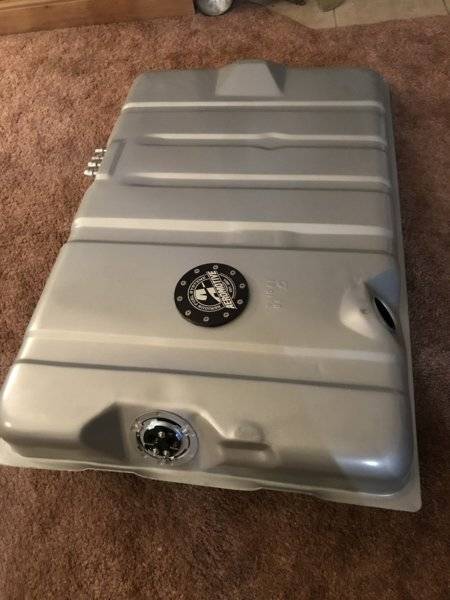

Thanks everyone for the replies. Aeromotive does have a good rep. They are the only in-tank fuel pump w proper baffling that I have found for a '67 B-body. It costs about the same as a remote sump. Does anyone know of another baffled tank w fuel pump installed besides Aeromotive?

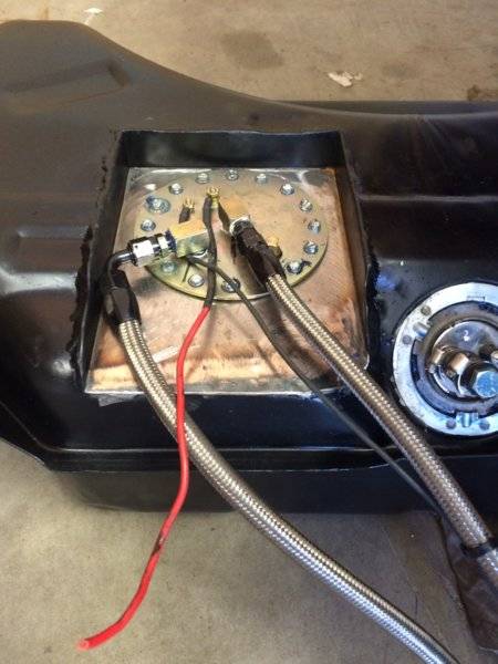

Green72, I don't quite understand your pic. Did you use a stock tank and then add the fuel pump in it? If so, what kind of baffling did you use to keep the pump from starving during cornering, accelerating n braking?

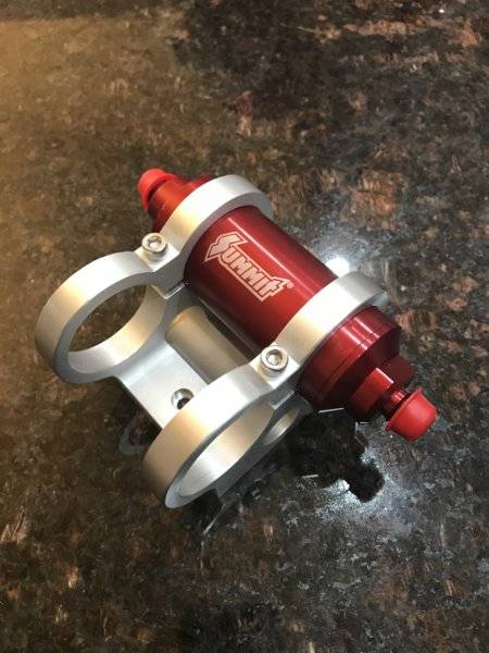

The ProFlo recommends two 10 micron filters, one before the regulator and then one before the fuel rails. So I designed a bracket that would give me easy access for maintenance and hold the filters securely. It was cheaper to go with the hard stainless line than 6AN braided hose. It also keeps me under 3 foot of flexible fuel line on the car. I’m full 3/8 stainless hard line front to back
