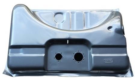

Larry since you have flattened out your pan it might be easier to go with a 68 EFI tank...
I just bought the in tank pump that I'm putting in my 67 satellite from Tanks. If you look at the dart tank posted above, Tanks makes the section that you can weld into your tank to recess the pump. I bought that as well. Everything seems to be well made and should be an easy project.

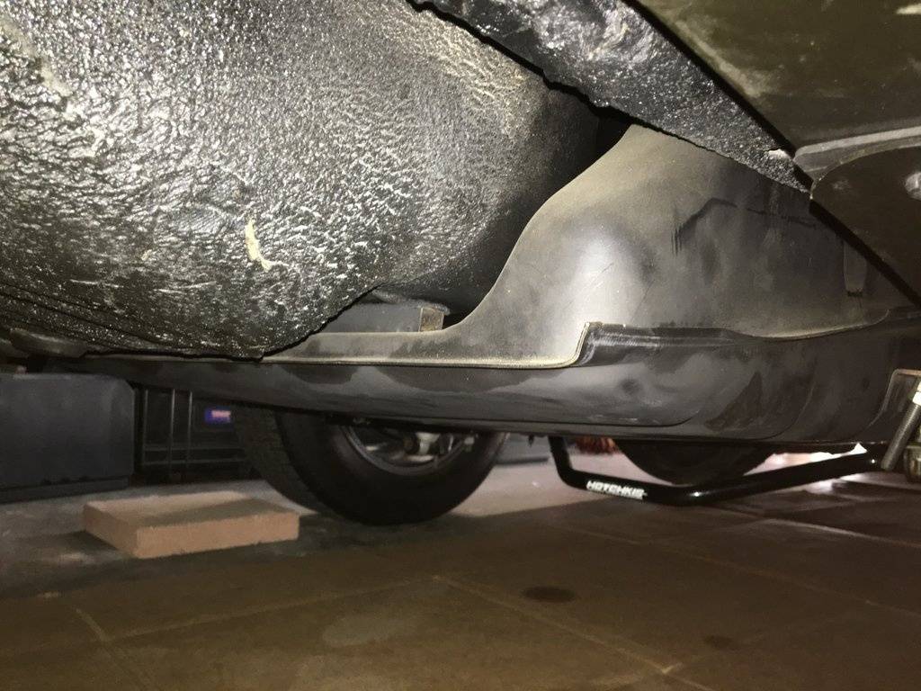

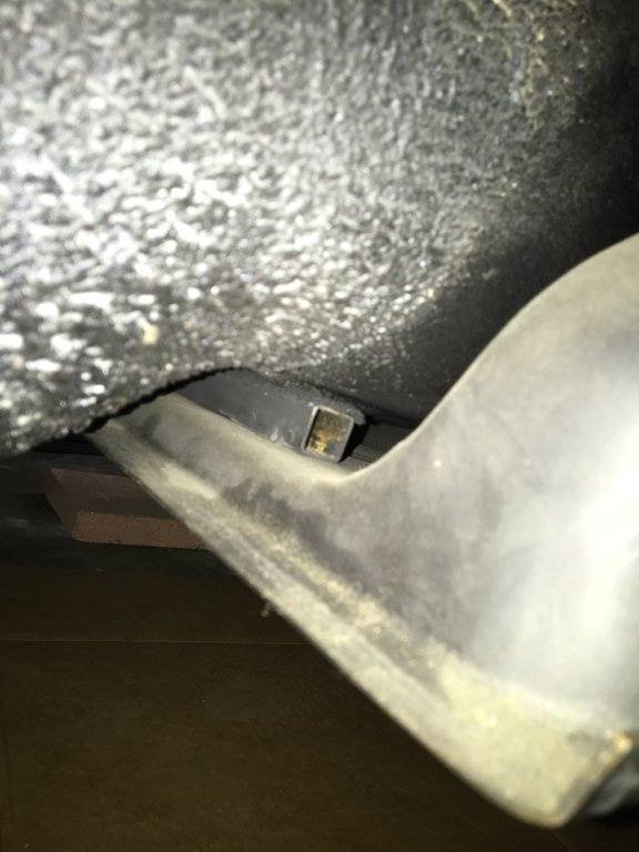

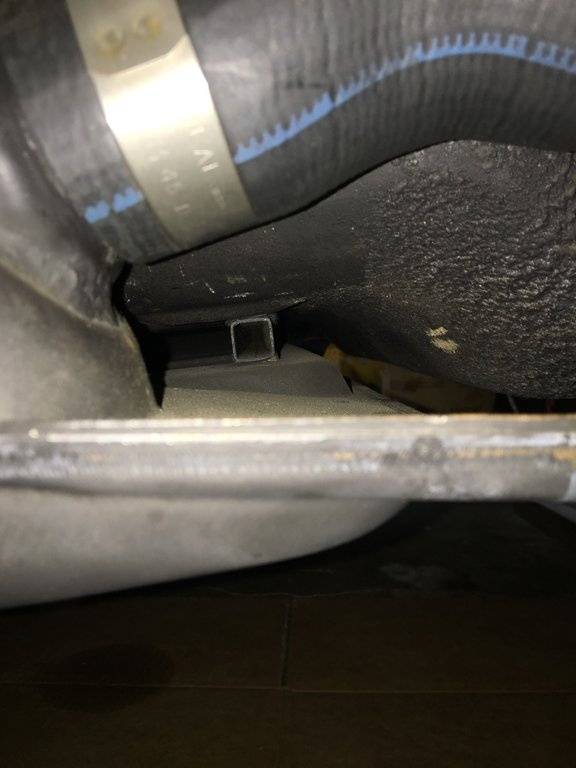

I have a 66 Coronet and installed an MSD Atomic EFi.
I used a repo Spectra fuel tank. I tacked welded some square tubing on top of the tank to shim it down just enough so that the supply/return fuel fittings didnt rub on bottom of trunk pan. I think this route was easier than welding in the tanksinc tray. The factory fuel tank strap works, youll just need a longer eye bolt from home depot.
I forgot which square tube size i used but i made sure to get something just a tad taller than the tallest fuel fitting.
Overall, you cant even notice the tank is dropped. Will try n grab some pics.

added pics
thought i had an extra piece to measure but don't. it just needs to be a bit taller than the tallest fuel fitting
so i added the pieces on the very top of tank as well as the wheel well location so everything shimmed down evenly. on the very top to the tank i made sure to leave a space so the fuel supply/return lines and power connections could feed through; it is not a continuous square tube on top if that makes sense.

stock photo of pump assembly added
you will need to cut a hole on top of tank. the flange of pump will be on top of tank. there is a support ring that gets inserted into hole of tank so it can get sealed fuel tight
the square tubing will be taller than fuel fittings providing the clearance
take a look at the tanksinc link. its a good overview
