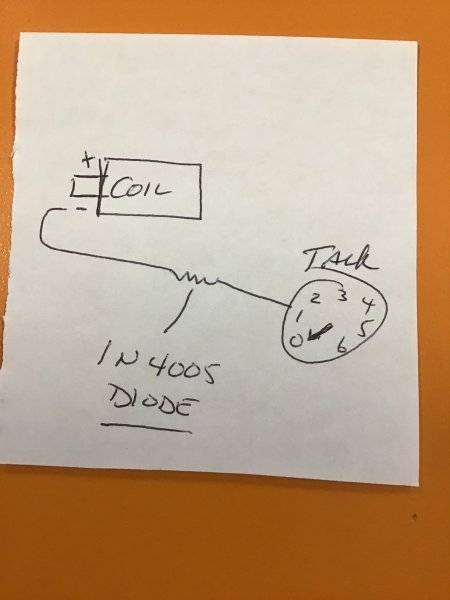

In my continuing quest to address issues with the Super Bee, I see that my tic-toc-tach seems out of whack. I think it’s ok down low, but where the gear/tire calculator says I should be spinning about 2600 rpm at 60 mph, I’m at 3000 or a little over. Plus the needle tends to bounce around.
I’ve done a bit of research and want to pass this by you kind people.
Apparently a 1N4005 diode inline on the wire between coil negative and the tack will settle the tach down. Does the below look/sound right? Does anyone have a picture or two that shows this implemented?
Thanks again as always for your help!
Bob

Do you have electronic ignition ?? If so, your tach needs a conversion to properly read accurately.
I have MSD ignition. What kind of conversion are we talking here?
MSD Ignitions need a tach adaptor to run correctly - Part number #8920

I put one of these in my 69 tic-top-tach, and set the calibration against a bench tachometer.
RTE 67-74 Tach kit - rte
ABSOLUTELY....i installed the RTE tach board in my origional MOPAR TIC-TOCK-TACH in my RS23V0A****** GTX and it operates more accurately than the original.....but...I have a Prestolite dual point distributor with points....no electronic anything.....
BOB RENTON
Even with the correct MSD tach adapter the factory tach in my GTX wasn’t very accurate. I swapped it for a reproduction from Redline Gauge Works that uses VDO internals, problem solved…
