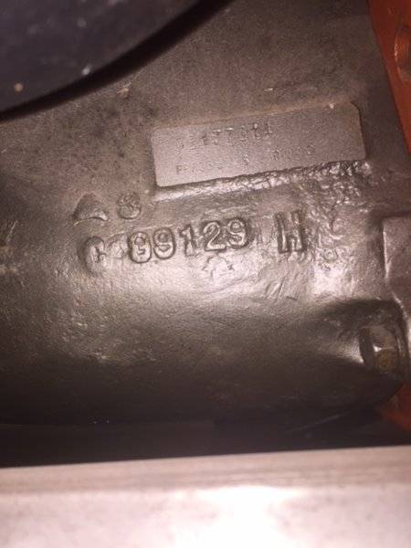

As for the 833 id, fairly simple. There will be numbers stamped and cast into the transmission, on 68 and later transmissions, there will be a raised pad with a bunch of numbers. This is the trans build date (10,000 day calendar).
Also, if it's original to the car, there will be a small 1/2" x 3" long flat spot near the bottom of the transmission that will have the last digits of the vehicle VIN number, I believe passenger side & I think '68 was the first year they did that (?)

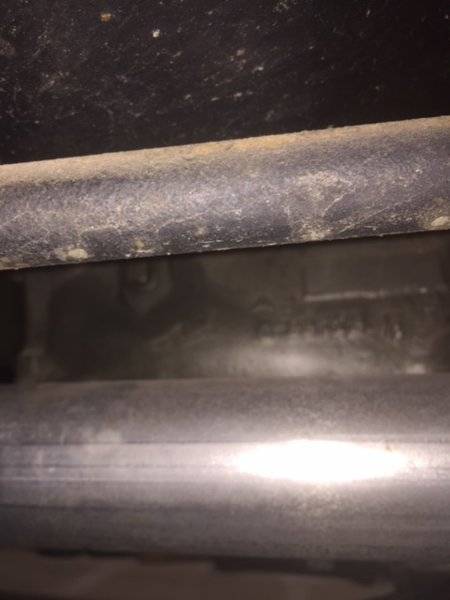

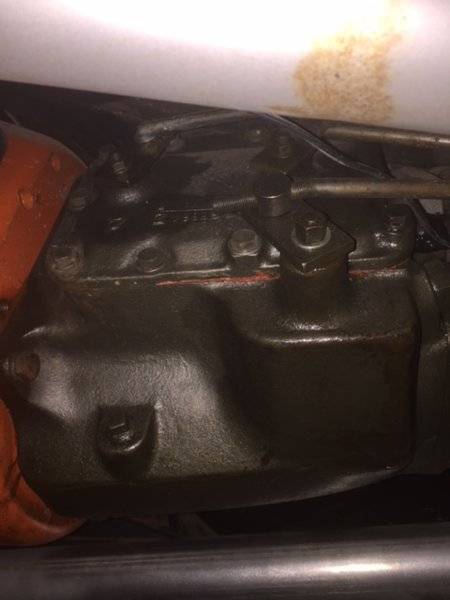

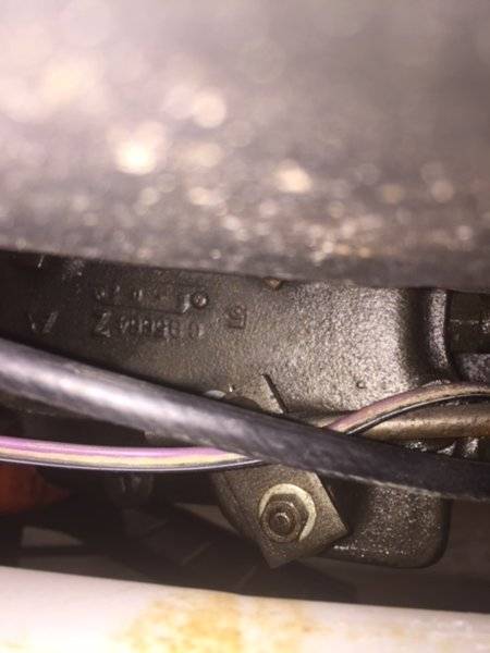

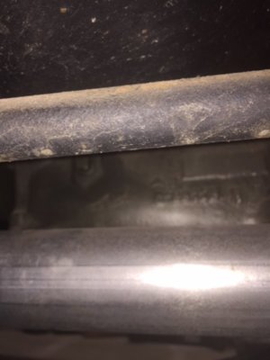

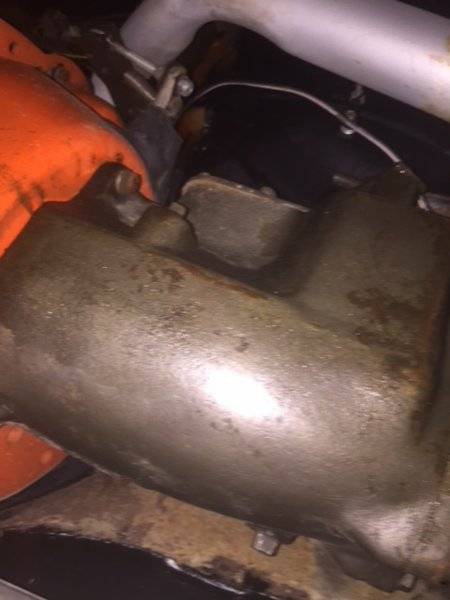

Ok guys, heres a few pics, looks like an 833?
Anyway, i have a leak...(of course seller never mentioned), but it APPEARS it could be around the i assume what might be a re verse light switch? I dont know what else would be wired to tjis tranny, unmless the speedo is electronic? Its located on the drivers side.....

1. for the leak, just pull out the plug, clean with carburetor cleaner & replace the o-ring and see what you get. that is the reverse light switch for sure if it has wires running to it.
