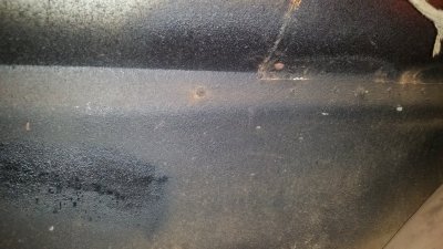

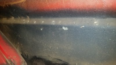

Looking for inside boot pics on how the different styles of rear 1/4s were attached. ie 4door to 2door? Are these factory or replacement?
Replaced. You can see where the welds burned the inside. the tell tale smoke/soot above the welds, and the rattle can undercoat to (attempt to) hide the evidence.
Look wayyy up in there with a flashlight. up where the undercoating can't reach.
I can't see a seam. so those might also be weld on dent pulling studs that were used at one point. find where the seam is
On the hdtp. cars the 1/4s were attached spot welded at the B pillar, and trunk drip rail! Not sure on the sedans how far up they went on the C pillar! Pictured ones are either repaired or replaced at one time!
Plus the factory quarters were undercoated before they were hung on the car which is why there is not over spray on the wheel tubs.
