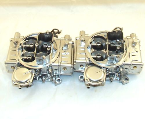

Does anyone have any experience with lstahle (Lyle Stahle) on ebay, or better yet the reman'd carbs he sells? Seems like a fair deal for a rebuilt, powdercoated pair of 600 cfm holley's @ $495/pair.
I don't know anything about that seller, but for that price you are within maybe 10- 20 bucks from a new pair.. and those in the picture are missing the choke.
Really Bbodee? up here in Canada I am likely shelling out 7-800+ clams for a new set...Time for a trip across the border! The pic's are just an example, he says he would include manual choke and a choice of colour for the powder coating. I just checked Summit's site and see they have reman'd Holley's for 259.00 each... The powder coating looks nice on the latter set!
