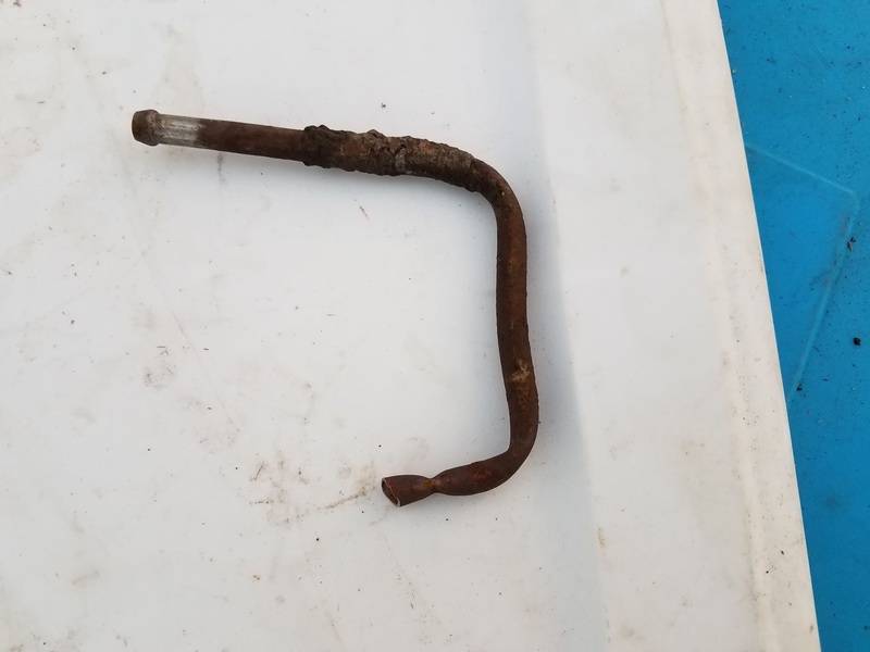

So giving an update to the thread. We ordered the electric pump. During the part when looking to install one other guy noticed a kink in the fuel line. So we cut the hard line out and replaced it with some rubber hose. Good news is that on the fuel pressure gauge we installed at the same time we got a constant 5.5psi cold 4.5psi hot. Gauge says a 1psi drop is normal when hot.
Picture of the kink. Behind the place were we tired to cut it off at the 90 degree bend on the bottom of the picture. Amazed we did not see this sooner.

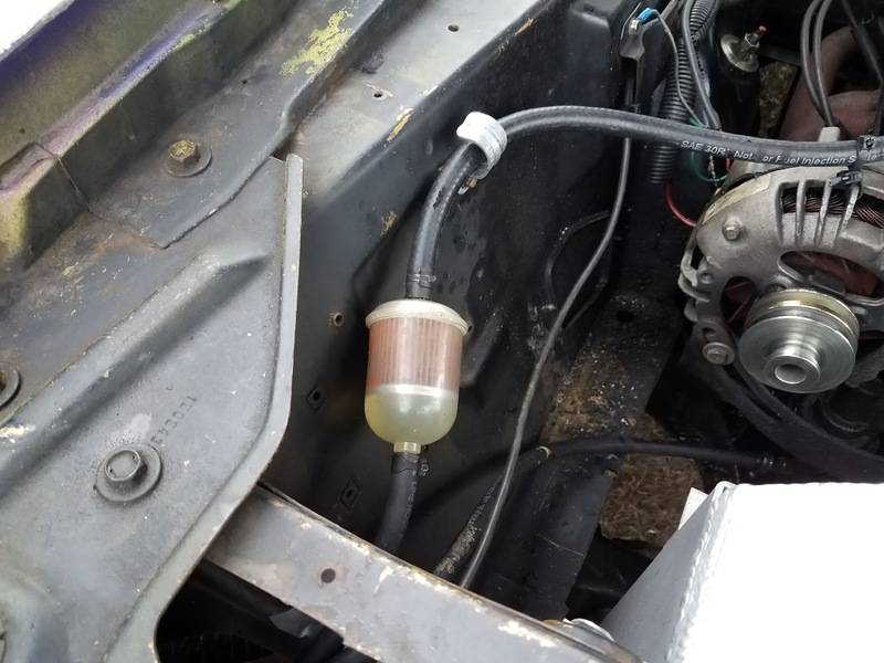

One full fuel filter for 14 hours of racing. No hot start problems no fuel starve problems. Problem seems to be fixed. Ignore the missing alternator belt. We lost that with 45 mins to go.
