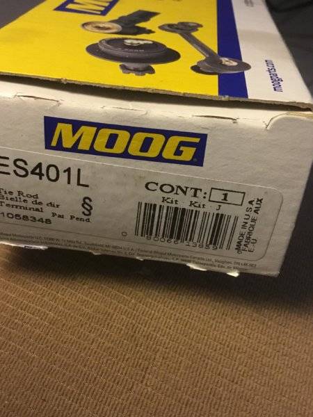

A couple years ago I bought Moog inner and outer tie rods for the car. I think Moog sent me something wrong. When you try to turn the spanner it unscrews from one side onto the other. It does not move them in and out from one another. I want to purchase a full set with the I think its called the spanner. You know the part that the tie rods screw into. Anyhow if anyone has a good source let me know. I'm not buying from Moog again I paid over 500 for all new everything but that was 2 years or so ago. The alignment guy was telling me they weren't right. I should have listened to him then and sent them back.

I thought that too. However I was thinking Mike67 is correct. What I think was they sent me 4 inners or 4 outers. THe odd part is they were able to screw into the center piece with no issues. When I put them together it didn't dawn on me. If they are indeed one reverse thread it makes total sense. But then again why was the center section normal threaded? This is why I'm just going to replace all of it. Both inners and both outers with new centers. I priced all of it at PST as suggested the price is 172.00 ish. But haven't applied the I'm a member of FBBO yet.

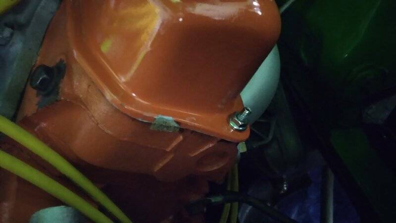

Got the PST stuff saturday put them on today. I have to say Very nice stuff. All went well and easy. I'm pretty sure I have the alignment very close. Steering wheel is just a touch to the right of center. A little more tweaking but I think its close. Wish I didn't have play in the wheel though. I think its in the steering gear. Which is a firm feel stage 3. Or whichever version was the police stage. And I still cant get the damn passenger side valve cover to stop damn leaking. That will be my next task as well as a Lokar setup for both the throttle and kickdown. And then a new set of trans cooler lines.

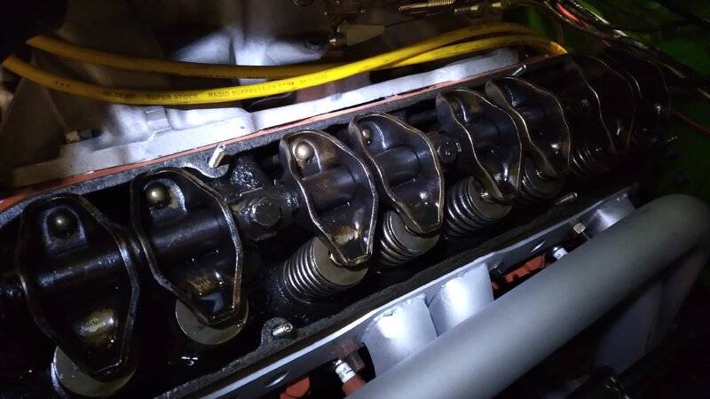

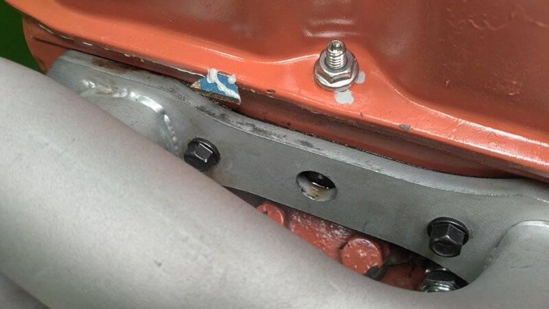

I think the problem with the valve cover leak is the casting where the valve cover goes is thin in about a 2 inch place. And its not a flat surface. Kind of rounded off certainly not a flat surface. I think it was just a badly casted 906 head. Had Moroso permalign gaskets which I swear by and even those leaked. I guess it will just be a gob of silicone to seal it up.
