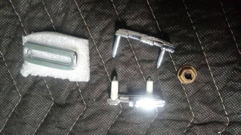

i bought new letters for hood '67 charger a number of years ago. don't know how to put them on.
there is a plastic sleeve on tips. does it stay on or not? if it stays on i will have to drill holes bigger.
if it comes off do i fasten letters on with push nuts? no threads on points.

The sleeves get tossed.
Wax the area before installing.
You need speed nuts like the one shown.
They cut a little groove by themselves.
Make sure they have the correct inside diameter.
Carefully try a couple on in your hand before trying a letter on the hood.
Use a nut driver and not real tight.
It's not tough just take your time.

Don is spot on.....
Double check the self tap nuts.
" Make sure they have the correct inside diameter. "

Those nuts are available from NAPA in various sizes.

I would run the speed nuts on and off once before installing. It’s less frustrating than finding out in the middle of installing them in tight spaces that a speed nut is too big but won’t back off, or not correctly cutting threads on the stud.
