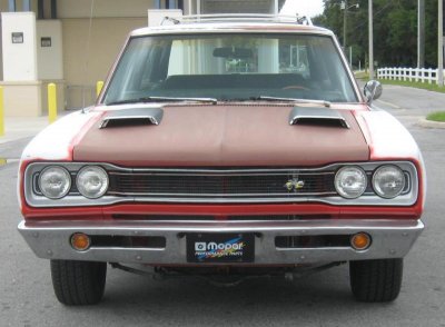

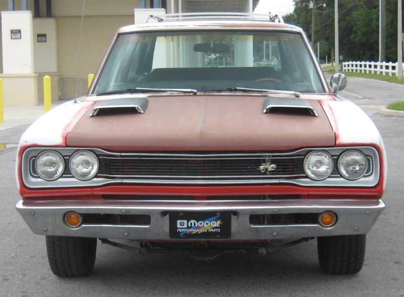

any one know where i can find a template? or is a transfer punch the way to go. any sugesstions will be appreciated,thnks in advance.

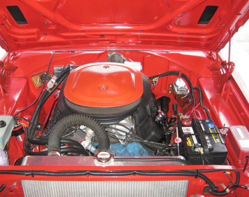

69 wagon (28).jpg69 wagon.jpgThey sell the templates at the Mopar shows (a buddy of mine bought one), but you really don't need it for the scoops. There are several holes in the bracing underneath already. Use a socket to center the holes and drill them out. Then place the scoop on top, line the studs up with the holes that you just drilled and mark the ones that still need to be drilled. Good luck!
sublime 68rr I have all the measurements for the scoops
