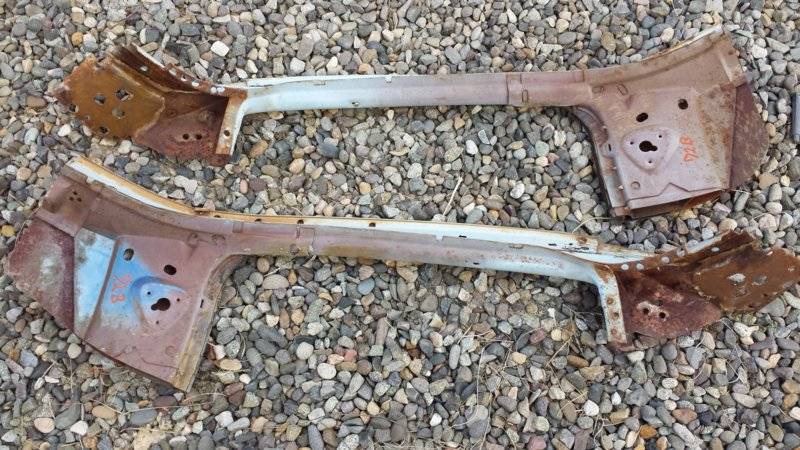

My 73 Charger needs a new roof. Looking at the factory parts book, the A pillar ends about three quarters of the way up, and there is a Y shaped piece that is welded on and then the header assembly.
I have a donor roof and was wondering if anyone has separated the pillar at that 3/4 mark and worked the new panel in like factory? My front header panel is shot but the rear looks ok. I also have localized rust damage (skin + structure) above the b-pillar area on both sides. Ideally I’d like to keep the rear header assembly on the car together and install the rear of the donor roof as a skin while welding the front in on the factory A pillar seam. I don’t really like the idea of cutting and splicing the A pillar like I’m chopping a 32 Ford.
Thoughts? Thanks

These are B's. Unless I read the book wrong, the A-pillar itself is the same for coupe/sedan. What's different is the piece that attaches at the top (where the sun visor would mount to - you can see the panel overlap on the pillar) and the header.
What I'd like to do is break it free at the overlap joint but that may be more trouble than it's worth. Would probably have to drill the drip rails (not reproduced) and I'm guessing the roof/pillar seam (exterior) is leaded.

I know someone who replaced a rusty header on the roof
but they cut out and spliced in another donor header right about where the part in the pic is cut.
I'm guessing your donor part was cut thru the a frame

I didn't buy the yellow roof, I picked up another one a few years ago. It's cut through the pillars a few inches below the overlap joint and maybe 4-5 inches into the c-pillar.
I also have a good pair of A-pillars from a sedan if I need to use them, but they are too tall with the header attached. I won't know how bad mine are until I pull the windshield.
Third option I find another donor roof with full a-pillars. Or, if I do cut/splice the A's, I could probably slip a piece of tube in there so I get good penetration and don't create a shear point.
