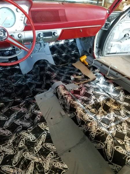

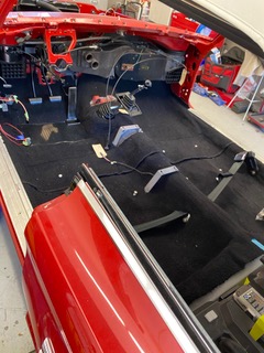

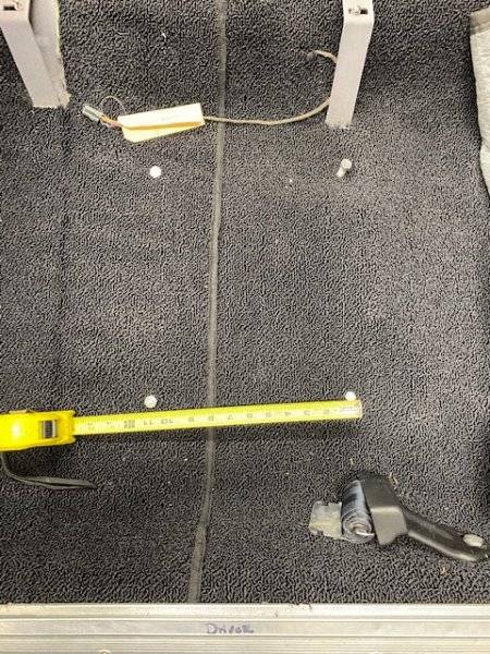

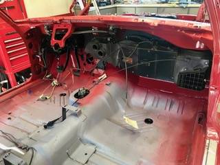

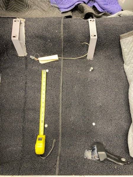

Hello Jorge, these are from my 66 Coronet. You can then see what yours looks like. Here we go with the pics, I will explain after the pics.

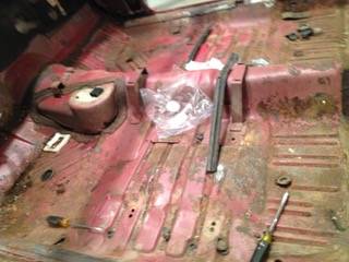

Jorge, again, this is a 66 Coronet. So on the first pic, if you blow it up you can see in the Front The seat holes. Obviously, this is before any body work. On the Second pic, you can see the floor pans before sound deadening and carpet. If you look at the left side, you can see there is one set of holes along near the Tunnel. Then to the outside of that, near the Rockers, you can see two holes each front and back. My guess is one is for Bench and the other for Buckets? Then on the second row of Pics, you can see the heads of Bolts that are "place holders" for the seat studs which are attached to the bottom of the rails. The other two pics are measurements for holes for the 66 Bucket Rails. They are, on centers, 13 by 11 inches apart. On the bottom side of the car, these holes are in into Braces to add strength to the floor pans where the seats attach. You might check your car to see where the Bolt Holes are and compare them to these on the 66. If you have any other questions or need any more pics, please let me know. Best, B.
Here is one more pic of the Floor before any work was done on the car. You can better see here the holes near the Tunnel and then the two sets of holes near the Rockers. Good luck.
