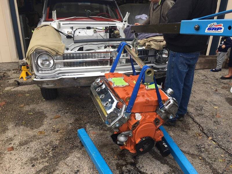

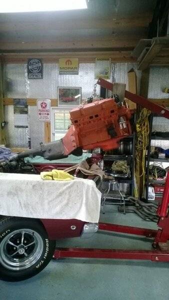

I just reinstalled the Hemi in my 68 Charger through the top and it was one of the easiest installs I've ever done. I installed it with the clutch and bell on the motor and put the 833 in from underneath.

My Hemi is an automatic car easy. With a 4 speed having an engine leveler so you can get bellhousing into tunnel would help. Have it tilted so rear of engine goes into trans tunnel first. Make sure you don't have pass side insulator on backward, don't ask why I know.

Done a couple of my Hemi cars from the top with no more issues than dropping in any other type of engine combo. Just tighter tolerances on everything to squeeze it in.

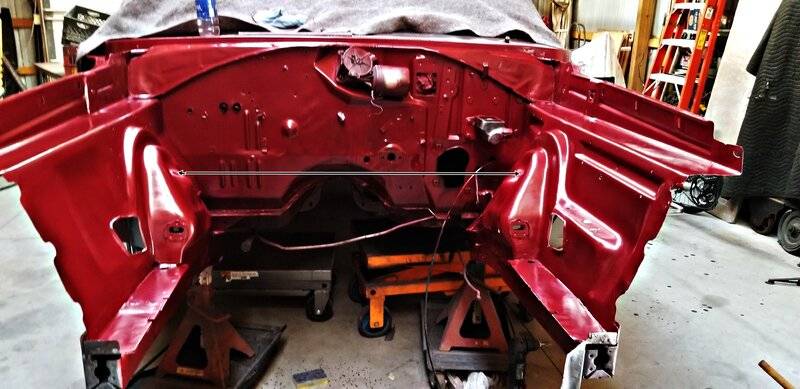

I am about to install by lifting front body up thru shock tower mounting holes with cherry picker.
The K member will be already attached to engine mounts.

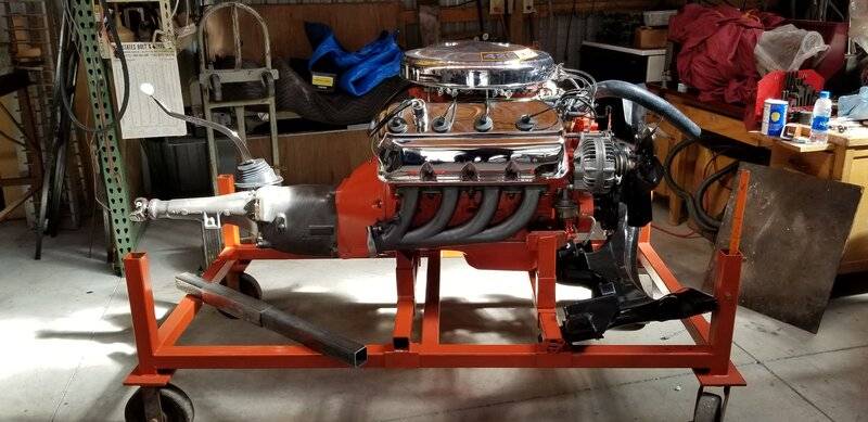

My engine is mounted to a engine stand ready to back in place.

Thanks for all of your comments, photos and suggestions. All options are on the table and once I decide which way I will put the engine back in, I will document with photos for the Forum. In order of ease, the engine only from the top makes sense except for the installation of bellhousing/trans laying on my back. A compromise to install the engine and bellhousing (Fran Baker) installation with only having to slide the trans in laying on my back seems reasonable. Finally, as Bold and Gold did, removing the K member/front end assembly, fasten the engine to the K member fully dressed with all accessories and lift car from shock towers and slide in, seems the most efficient, as long as I take the time to dissassemble the K member/front end, have a dolly made or purchased, and have a few buddies on hand to help me.

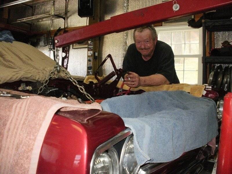

Now, having said that, how'd I do it last time with my 440/A833 - by my old scraggly self, no less?
From the top...
DON'T DO THAT. You'll wind up looking like me! :thumbsup:
