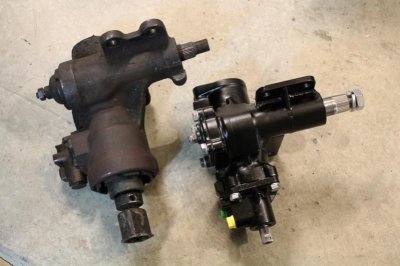

We're doing a full write up on the install afterwards, and will be testing the unit out this weekend at Willow Springs Raceway. The gear is about 13 pounds lighter, and is a quicker 14:1 ratio giving the car a modern power steering feel - firmer than the factory units.

Here's a comparison of the two gears:

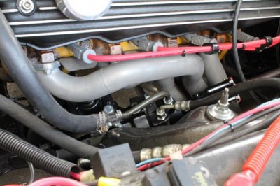

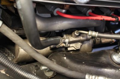

Man ! !... How About That Header Clearance !

Oh.. and header clearance? LOTS of it now!

I don't want to spoil the article, but here are a couple of pics showing the difference in size and header clearance.borgstrggr.jpgfactstrggr.jpg
