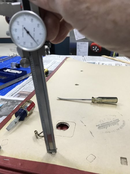

I plan on installing the clips, or at least try to. I’ll see how it goes removing the initial layer of board and cutting the pocket. Not sure the small screwdriver with a curved (bent) tip is up to the job. I’ll try sharpening it and if that isn’t effective, fabricate a tool from a piece of rod I have. It sounds like Legendary used to supply a tool some time ago but they don’t mention one being available now.

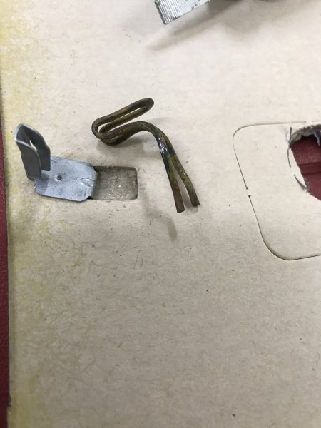

I wasn't too keen on cutting out the backing for the clips. The wrinkles did go away after a day in the sun. I have replaced some of the metal clips with the plastic Christmas Tree type ones. THey push i easy, hold tight, and don't disturb the paint like metal clips can.

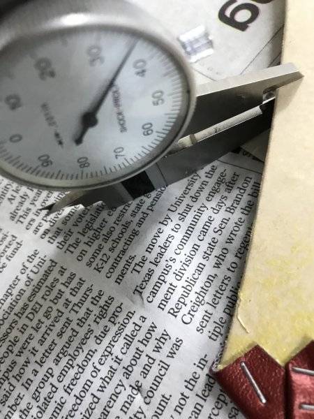

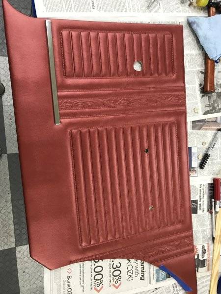

I got the back panels done. It’s kind of nerve wracking digging out the cardboard pocket. Even though Legendary perforates the cardboard it looks like they perforated it nearly all the way through. On the edge I measured the cardboard at about .130-.135” which is kind of an odd dimension. The first one I dug out about .110” deep before I realized the perforation was nearly full depth, but it looked OK with a clip installed. After that I shot for around .090” depth so there was still plenty of board to be able to pop the clip loose without damage to the board (I hope). I think Legendary adds a very thin layer of felt between the board and the vinyl that may have not been in originals. That may help prevent the clips from showing through on the front.
I’m going to switch to the sheet metal clips like my old 64 Sport Fury had. I like them better than the wire clips. Rear done.
