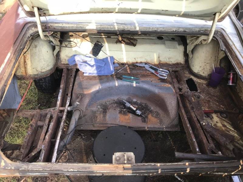

Buy about 3 of these and a center punch and you will be on your way. The hardest floor pan spot welds to get to are the ones up front at the pinch weld for the firewall. They are not exposed from inside the car and would have to be done from under the car, well depending on how bad your pans are.. If they are rotted out with huge holes you can do it from inside the car. This is the trunk area but you will end up with something like this..
