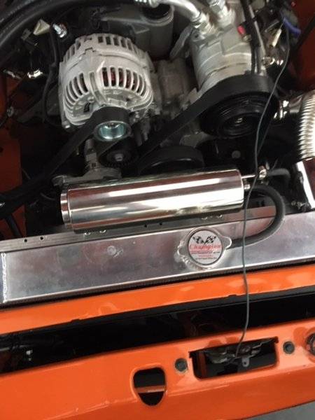

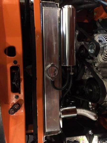

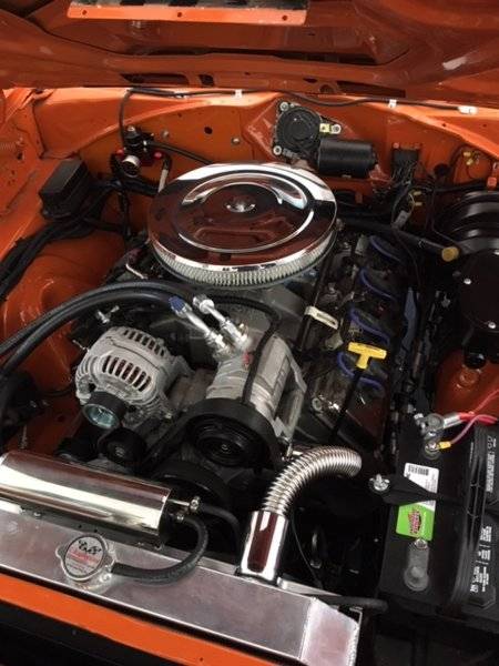

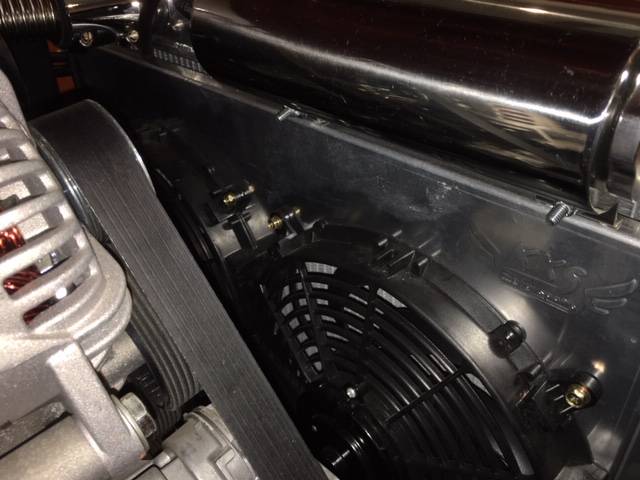

To be honest I've never started my car so don't know if it will get hot. I'm using a 3 core champion radiator with duel electric fans but my car is not stock - has a 5.7 late model motor.
https://www.forbbodiesonly.com/moparforum/threads/5-7-hemi-engine-swap-on-70-rr-project.151252/
