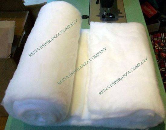

While on my way to the Power Tour several years ago, the wind turbulence tore my dry rotted head liner loose. I had to do a quick repair and taped it up, but had to pull some of the factory insulation loose to get the tape to stick. When I had the headliner replaced I brought some batting to replace it. The guy who did the job said he doesn't normally use it, but since I supplied it he used it. My wife got it for me from JoAnne Fabrics and said it was "crib batting", used for quilts. It'e been in for at least2 years and I've had no problems so far.
Looked something like this. I doubt it will be heavy enough to sag.

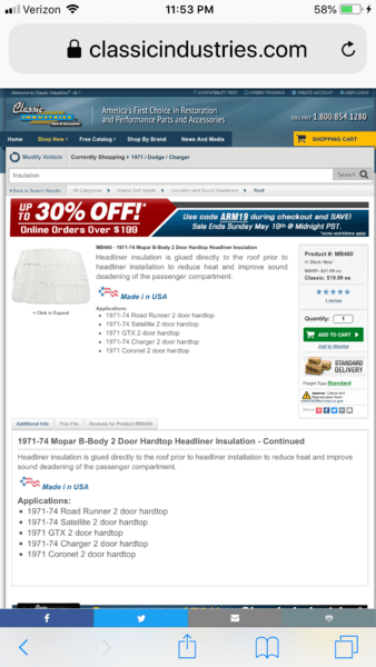

I used dynamat too! I had bought this (picture) from Classic Industries, but never used it. The item was only $20, but if someone wants it, and pays for the ride (there lies the challenge), they can have it (91208).
