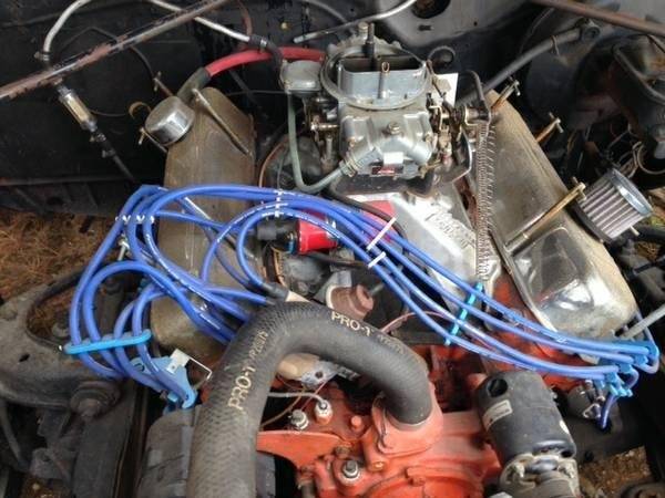

Ok I swapped out the 383 Torker intake for a 383 Performer RPM on my 400 low deck drag car & now my engine runs like crap & the idle is all over the place making me think I have a big vacuum leak. The guy I bought the car from told me the heads had been cut a lot on the 400 low deck block to raise compression. The RPM intake bolted on nicely & seemed to fit good but I’m thinking the 383 torker was cut as well. Nothing else was done. Just swapped intakes. Any ideas ?

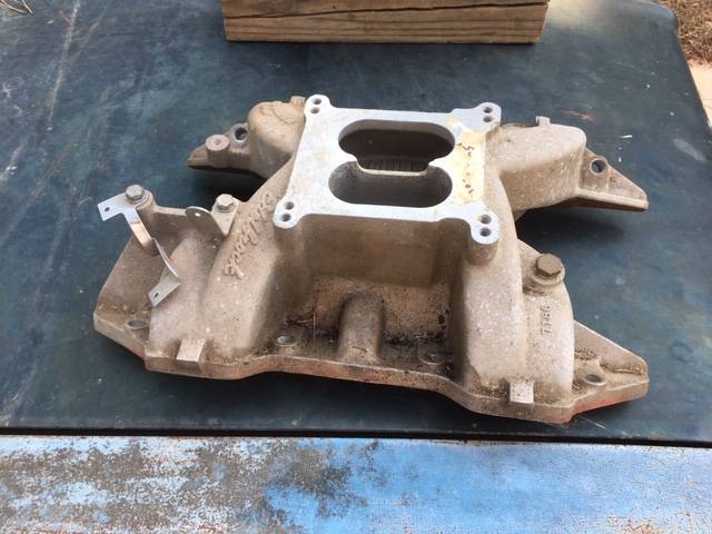

Neither intake has a China wall. See pic attached. Just the side flanges.
