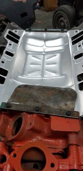

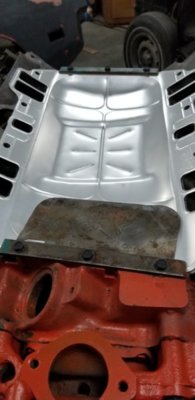

This does'nt look right.
Flip that insulation hold down piece around so it’s straight. You really don’t even need it unless you’re putting the insulation back or just trying to have it look completely stock. Once the insulation piece is gone, that metal thin steel piece serves no purpose.
