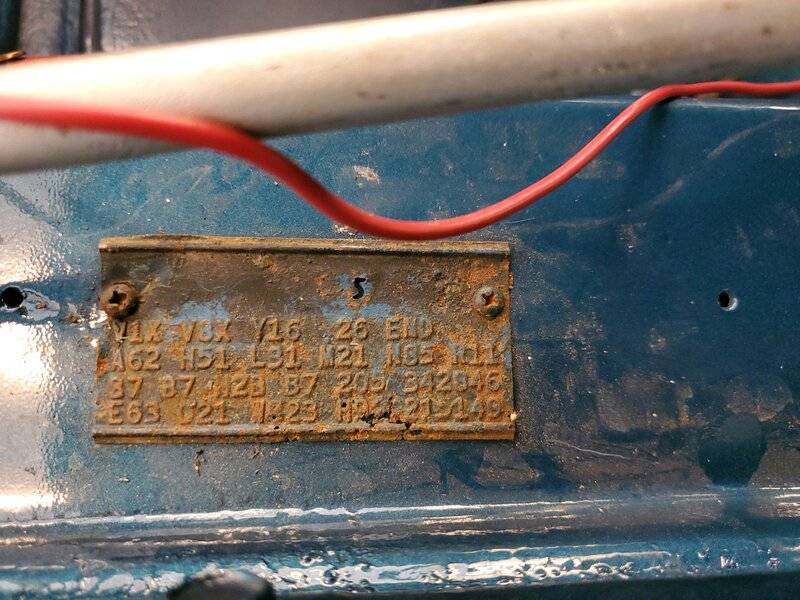

The fender tag has B7 in three places, I get the outside is b7, etc. Does this mean B7 for the interior and assuming so, my questions:

We could probably help better with a photo of the fender tag then.
The third B7 is your interior upper door panels like stated above. H2B is your interior, vinyl bench seat light blue.

Pretty much everything will be blue. I have never owned a blue interior car, but have had one that was T7. Everything was tan/brown. Several different shades between the kick panels, dash, dash pads, door cards, steering wheel, seats, headrests, etc.
