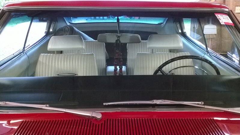

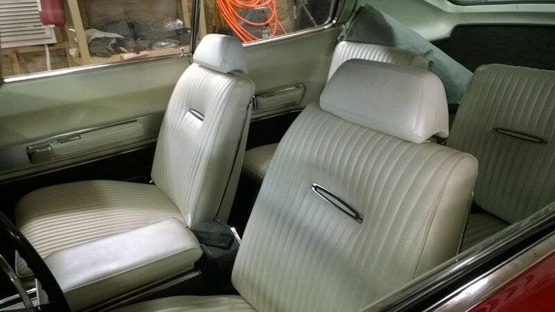

Some things. White interior: black carpet, kick panels.very bottom of inside door frame, headliner, console and top moulding on the back window. Yes you are missing a small piece that has a screw that goes through it.
This is what our 67 has. Haven’t looked at the seat bottom skirts, think they are white
Someone will correct this if I am writing, also someone will most likely add.
Good luck.

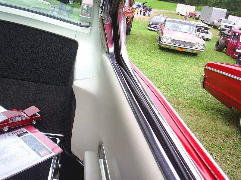

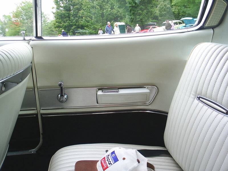

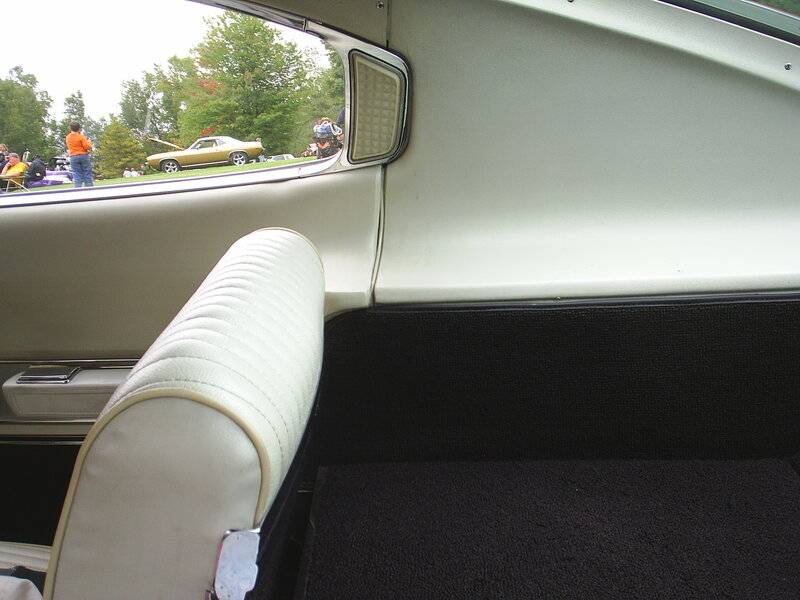

Go to my site, I have a white (pearl) interior. Carpet, console & headliner is black.
http://www.retrorarities.com/ChargerPage.htm
Thank you. The pictures are very helpful. However, I saw the guy about painting my panels and he told me not to bother. His observation is that they had been treated by armor all for some time and that paint would not stick. He said in his experience there was nothing he could do, or would do. He did tell me that if i found the panels and everything and they had not be treated he would consider painting them for me. So I am back to square one as to what I want to do.
