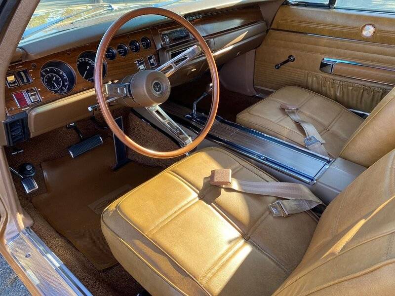

Could someone out there please direct me where to find this interior paint color for the dash, steering column, etc.
Paint shops I’ve checked so far don’t seem able to find a reference.
I believe the CRT code is for a tan interior but it looks pretty brown online.
The paint sample I have so far is also brown.
Is what they call “saddle” for the soft parts CRT or something different?
lastly, Is the dash top the same color as the rest of the dash or is it “blacked out”?
Thanks in advance for any help.

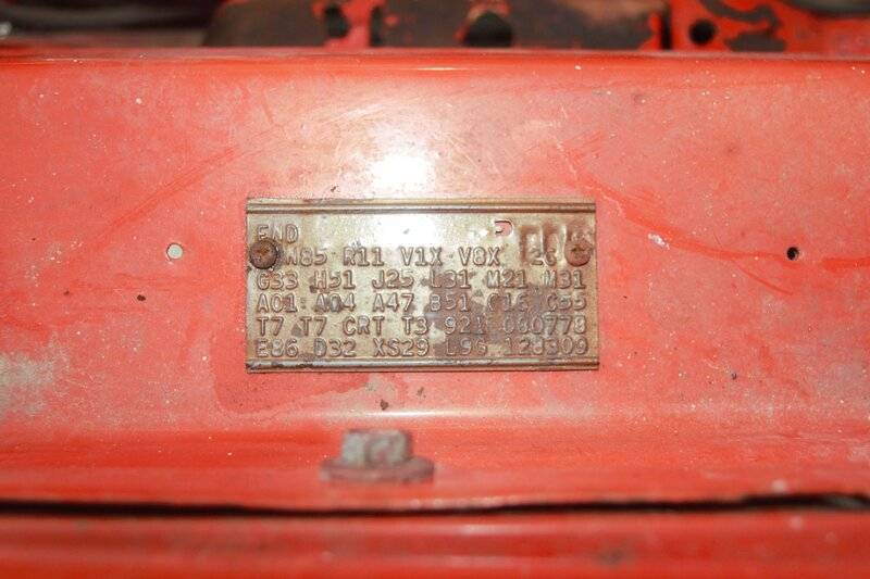

XS29:
Dodge Charger
Special, R/T
2 Door Sports Hardtop
L9G: 440 375HP 1-4BBL 8 CYL
1969
St. Louis, MO, USA
128309: Sequence number
E86: 440 cid 4 barrel V8 (High Performance) 375hp
D32: Heavy Duty Automatic Transmission
T7: Dark Bronze Metallic (Dodge), Saddle Bronze Metallic (Plymouth), Tuscan Bronze Metallic (Chrysler & Imperial) Exterior Color
T7: Dark Bronze Metallic (Dodge), Saddle Bronze Metallic (Plymouth), Tuscan Bronze Metallic (Chrysler & Imperial) Roof
CRT: Unknown Int.
T3: Light Bronze Metallic (Dodge) Int. Door Frames
921: Order number
A01: Light Package
A04: Basic (Radio) Group
A47: Special Edition Package
B51: Power Brakes
C16: Console w/Woodgrain Panel
C55: Bucket Seats
G33: LH Remote Racing Mirror
H51: Air Conditioning with Heater
J25: 3 Speed Wipers
L31: Hood/Fender Mounted Turn Signals
M21: Roof drip rail moldings
M31: Belt Moldings
W85: Unknown <---- "W" codes have something to do with Wheel colour or style.
R11: Radio Solid State AM (2 Watts)
V1X: Full Vinyl Top, Black
V8X: Tranverse Stripes, Black
L26: Unknown <--- "L" codes seem to be for Lamps.
Still trying to find a "CRT" code. "CTD" decodes to "69-71 Codes Continued on 2nd Fender Tag". I'm curious now too, so will peek around.

I don’t think that’s L26, It’s just 26 as in a 26” radiator.
Im thinking l’ll paint the dash, column, ash tray, etc T-3 light tan.

XS29:
Dodge Charger
Special, R/T
1969
St. Louis, MO, USA
CRT: Unknown Int.
921: Order number
A01: Light Package
B51: Power Brakes
C55: Bucket Seats
J25: 3 Speed Wipers
M31: Belt Moldings
CRT is Leather Vinyl Tan(Saddle) interior ONLY in Special Editions
