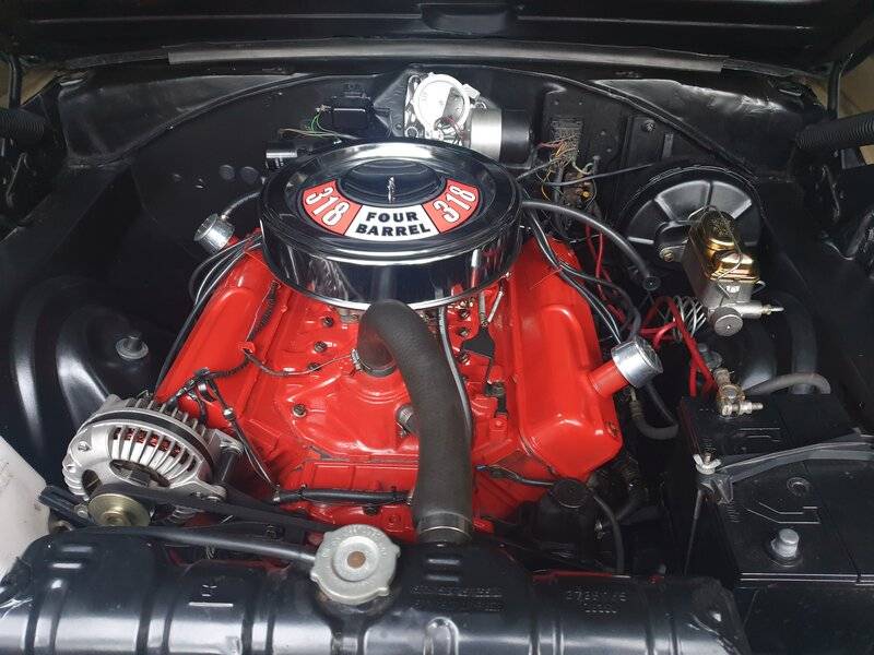

The booster is just one of those gold colored cheap ones that come with most of the conversion kits.

Damn....that is a clean looking setup you have there.
Thanks. Only 2 problems:
1. It says 318, not 440 or even better 426.
2. I painted the engine bay black in anticipation of painting the whole car black, but then kept the exterior Citron Gold. So now it's like a Chevy.
I'll try and get a valve locally tomorrow and hopefully that will be all it is.
With the engine being a Poly, it would be hard to fool a Mopar guy with any 440 nonsense!

They were 100% spot on, soon as I was your engine compartment picture I knew what was gonna be the problem... I try to tell folks but very few listen.... CHINA!!!! SUCKS!!!!
