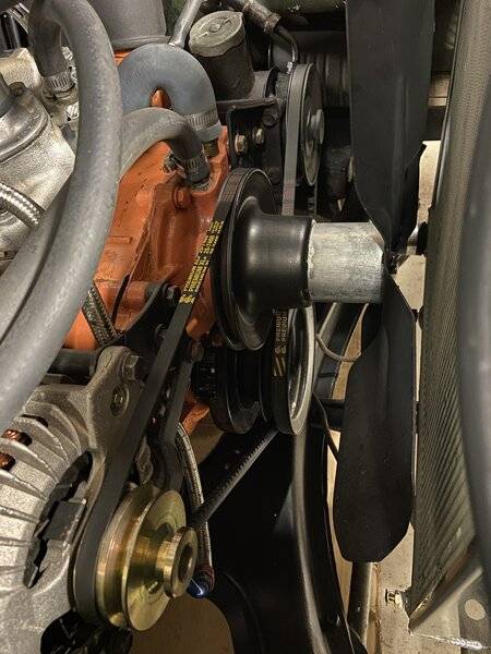

Thanks Moms 68. I have a question. I took belts off and am still getting the squeal when I give a little gas from idle. Wouldn't that mean it can't be the water pump? Does water pump still "spin" with no belts hooked up?
Attached is a photo of my 340 with power steering. With no belts only the crankshaft would be moving.
