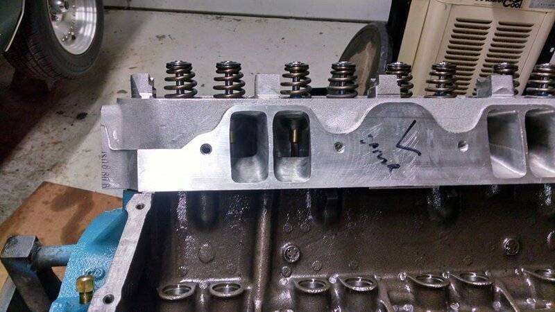

I have the 440 source Stealth alum heads Max wedge port, they look just like a stock iron head, with Stack EFI

I use cnc ported Stealth heads. My mild combo in a heavy car still runs low 11's in the quarter n/a and a best of 10.01 with a small shot.
