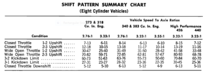

I'm not sure about 64, but in the later factory service manual transmission section, there is actually a chart that shows the speed range and specs for downshifting. Those old books have lots of good little details.

Kicking down all the way to 1st at 40 mph is a consequence of the TF-2 mods, normally won't occur much above 35 mph.
My 64 Sport Fury would hit first up to 40 mph with a 3.23 rear. This was in 1968 and essentially stock motor except somehow it acquired a dual point distributor. I took frequent advantage of it.
